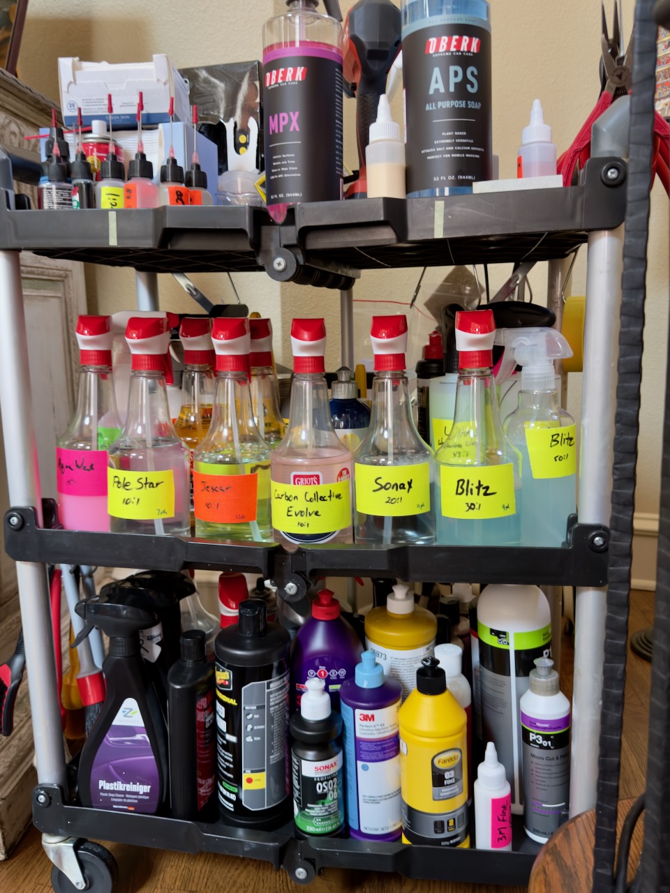

So I've spent the last 2 weeks carefully analyzing and grading the products I've bought to decide what are keepers and what to get rid of to make space.
I did great! I cleaned out about 25% of what I had.
So what to do with all that extra room on the cart?
I ended up buying double the number I got rid of to keep trying new techniques to find what works and what doesn't.
Oh, and the cart is at end of life and bending under the weight of the stuff so I have a more heavy duty one or order.
Future post: I'm now studying and understanding what makes a product more likely to work for me than not, so I can really better understand the product vs. restoration relationship.
Some VERY interesting info - in fact I'll go so far as to say the newer products are NOT better than the old school ones.

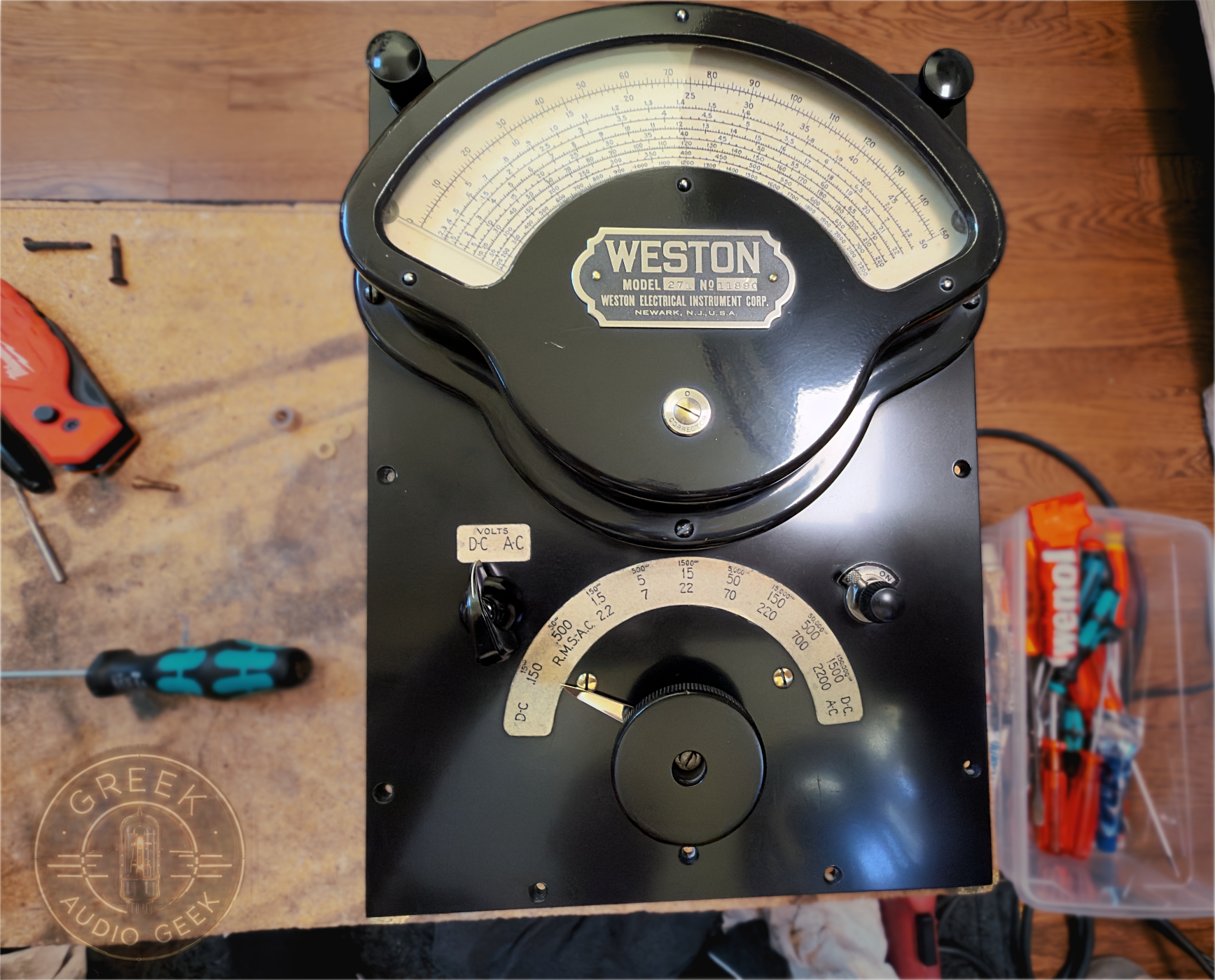

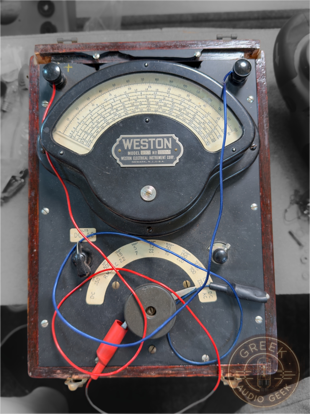

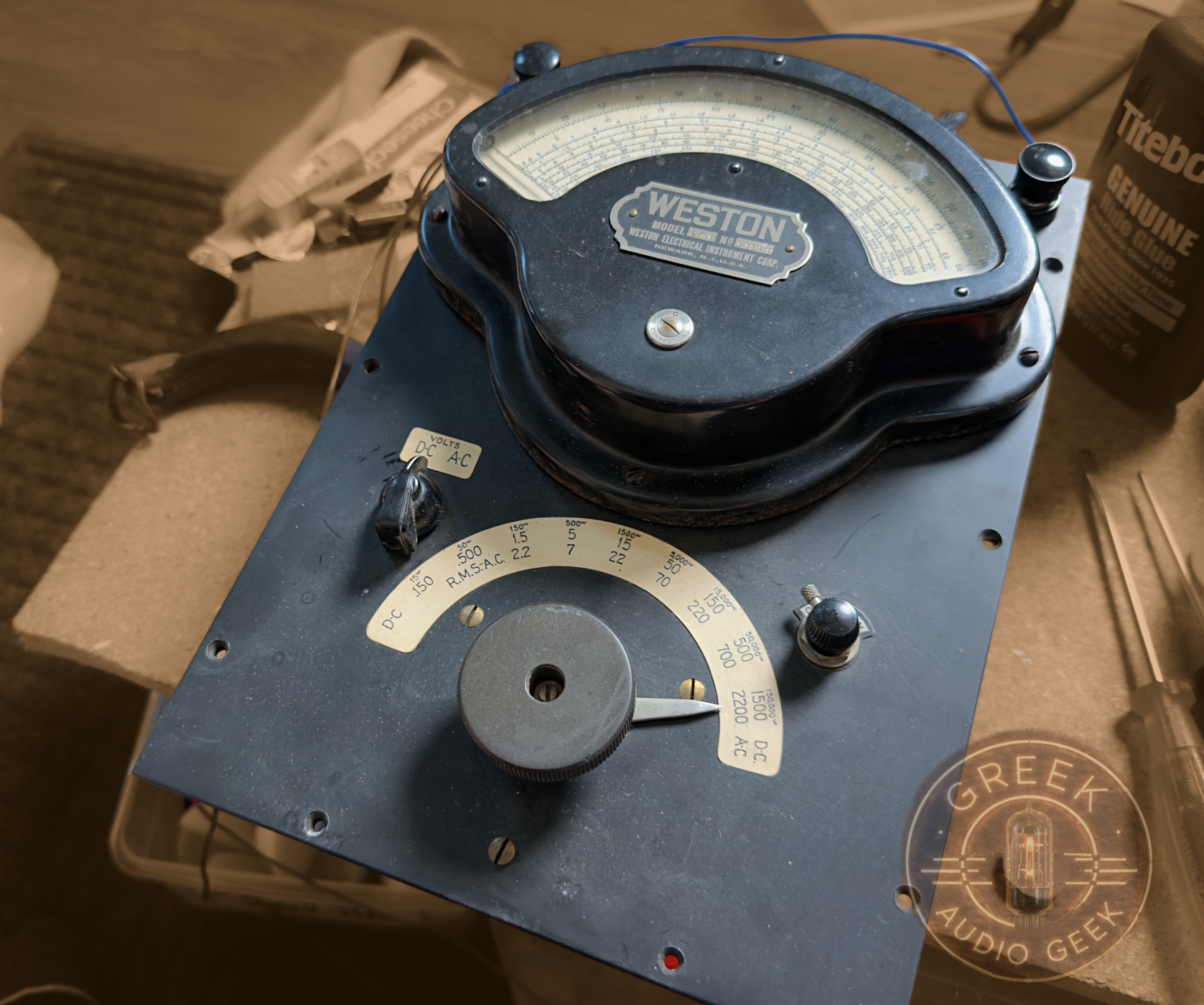

I've been restoring a 1930's Weston 774 that is the second worst faceplate I've ever encountered in terms of the amount and thickness of baked on dried into the porous paint oil, grime, nicotine and who knows what else that none of my go-to compounds would touch.
I tried a stack of products — Jescar's full line, Menzerna 1000/2500, Koch Chemie's fine and micro polishes, a couple of Meguiar's SMAT compounds and more. Nearly all of them either did nothing or just smeared the grime around without cutting it. Only a couple of products actually worked.
(Note I did initially try liquid cleaners and they didn't even make a dent in any of the grime that has hardened into a bullet-proof type cement).
That sent me down a rabbit hole, and the real breakthrough came by complete accident - the kind I find most exciting in this journey.
The accident: I sprayed a strong panel prep solvent on one of the testers to strip old product residue before working on it — something I'd used without issue on other testers. Within seconds, the black panel turned a faded, milky blue-grey. I thought I'd ruined it.
Turns out this is a well-documented phenomenon called lacquer blush — a whitish, cloudy haze that forms when a fast-evaporating solvent reacts with a nitrocellulose lacquer paint. Nitro lacquer never fully cross-links, even after decades — it stays chemically "alive" in a way other finishes don't. That's the whole reason it can be reamalgamated (redissolved and reflowed with solvent to heal crazing), but it's also why it's vulnerable to this reaction from products that were never designed with it in mind.
So I've spent days studying up on nitro lacquer as most of the other testers I have do NOT have that finish and learning about how to deal with them.
Thankfully a light mechanical polish pulled the blush out — but I learned almost every polish, compound, and glaze marketed today is built and tested against modern automotive paint systems, even when the label says "single-stage" or "all paint types." That language almost always means modern single-stage urethane, not 90-year-old nitro lacquer. As I just learned they're not the same chemistry.
What actually turned out to matter, mechanism-wise:
  • Diminishing abrasive compounds (most modern cutting compounds — Menzerna, Jescar) are designed to break down under machine-generated heat and pressure. By hand, without that heat, many of them just don't fully engage — they smear rather than cut. One exception: I found that working a diminishing compound feverishly by hand in a much smaller section, for much longer than feels natural, can actually get it to work by hand. It's slow, but it's real.
  • Fixed-abrasive "SMAT"-style compounds (Meguiar's M100, M105, M205) are often marketed as more hand-friendly than diminishing compounds, and in theory they should be. In practice I found they also didn't do too well. I don't have a clean explanation for why other than the finish is so old and fragile and also as I learned nitro actually dries out and needs to be revitalized. But I first need to clean it to be able to revitalize it.
  • Solvent-forward products — sprays, panel preps, some "chemical + mineral" compounds — carry real blush risk. Heavier, slower-evaporating carriers (like the kerosene-type naphtha in some paste compounds) seem much less likely to trigger it than fast-flash solvents like isopropyl alcohol. The water based compounds I tried did not have the ability to even touch the grime so the grime still needs solvent to break it down.
  • Oil-based "rejuvenating" glazes (Meguiar's #7 and similar) have a positive history on single-stage automotive paint. So after I am able to clean the grim off I'm going to be using M03 - a cousin of the #7.
What's actually worked for me, so far:
  • Farécla G3 and G6 paste compounds — older abrasive technology by Farécla's own admission, explicitly positioned for aged and very aged paint. Hand-safe, no water needed, no staining issues like some 3M compounds - which are darker in color - are notorious for.
  • 3M Rubbing Compound 05973 — the one product I found with an explicit "safe on lacquer and enamel" claim in its own documentation, not just "all automotive finishes." Confirmed cutting my actual grime by hand but the finish is so soft and dried out will definitely need a finishing and glaze step to remove polishing scratches.
  • Menzerna 400, worked hard in small sections — a genuine diminishing compound that does work by hand if you give it the technique it needs. However it left a *slight* blush from the solvents in it. So I've ordered the non-solvent version to try. So far the best performing.
  • Currently testing Meguiar's M02 (explicitly marketed for "older lacquer and enamel paints" — a real, written claim rather than inference), Meguiar's M03 Glaze and Menzerna 2400 (Menzerna's own FAQ singles this out as one of the few products in their range they explicitly recommend for hand use, and describes it as built for old, dry, "sticky" paint specifically).
The big takeaway: Holy crap is this far more complicated - and exciting - than I ever thought it would be!
Picture of it still trying to fight the grime without destroying the paint.
I'm generally a big fan of the Menzerna stuff.
It's a different kind of way to use them properly but once you get the hang of it genuinely great results.

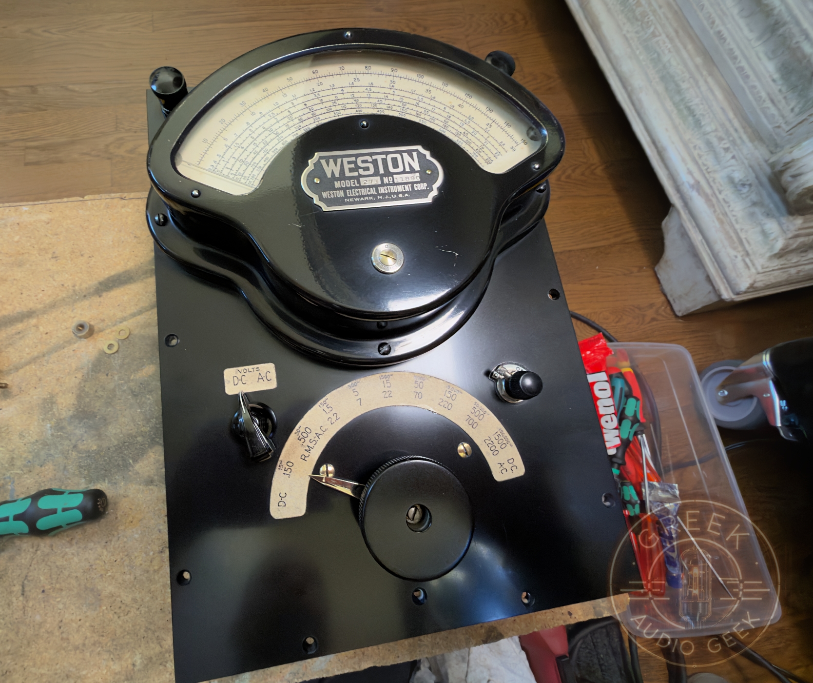

OK guys- some before and after.
I also filmed some video of the work and will be putting together a short vid on it.
Here are the steps I did (I know I am forgetting a few and the vid will show that). I always take them out of the case to restore the case separately and to allow me to attempt to restore the internals.
- Glue the top back together
- GENTLY wipe the entire unit with Rrw as it has lube in it to lightly clean while lessening the changes of scratching with the dirt
- Tried Blitz 30:1 - not strong enough. I can see it removing some of the 80 years of grime but doing a lot of smearing.
- Tried Sonax 20:1 not much better.
- Multiple applications of Jescar APC 10:1
- Then Blitz to wipe off any Remaining APC.
- M2 cleaner / cut. Not strong enough so I experimented with fine and ultra fine grades of polish only to jump back to a to 3M Medium cut polish.
- After numerous applications of that and then went to M2, then M3 (gives me cut and glaze) then M7 then Koch Chemie Grun sealant then s100 carnauba wax.
I add the s100 over the sealant as it gives it a more natural diffused rich satin look. The finish on the meter is different than the metal face (it's much softer and more delicate) so they required different techniques and application of products.
I know I am forgetting some applications but it took about 5 hours.
I also removed hand cleaned and polished each knob.
What do you think?

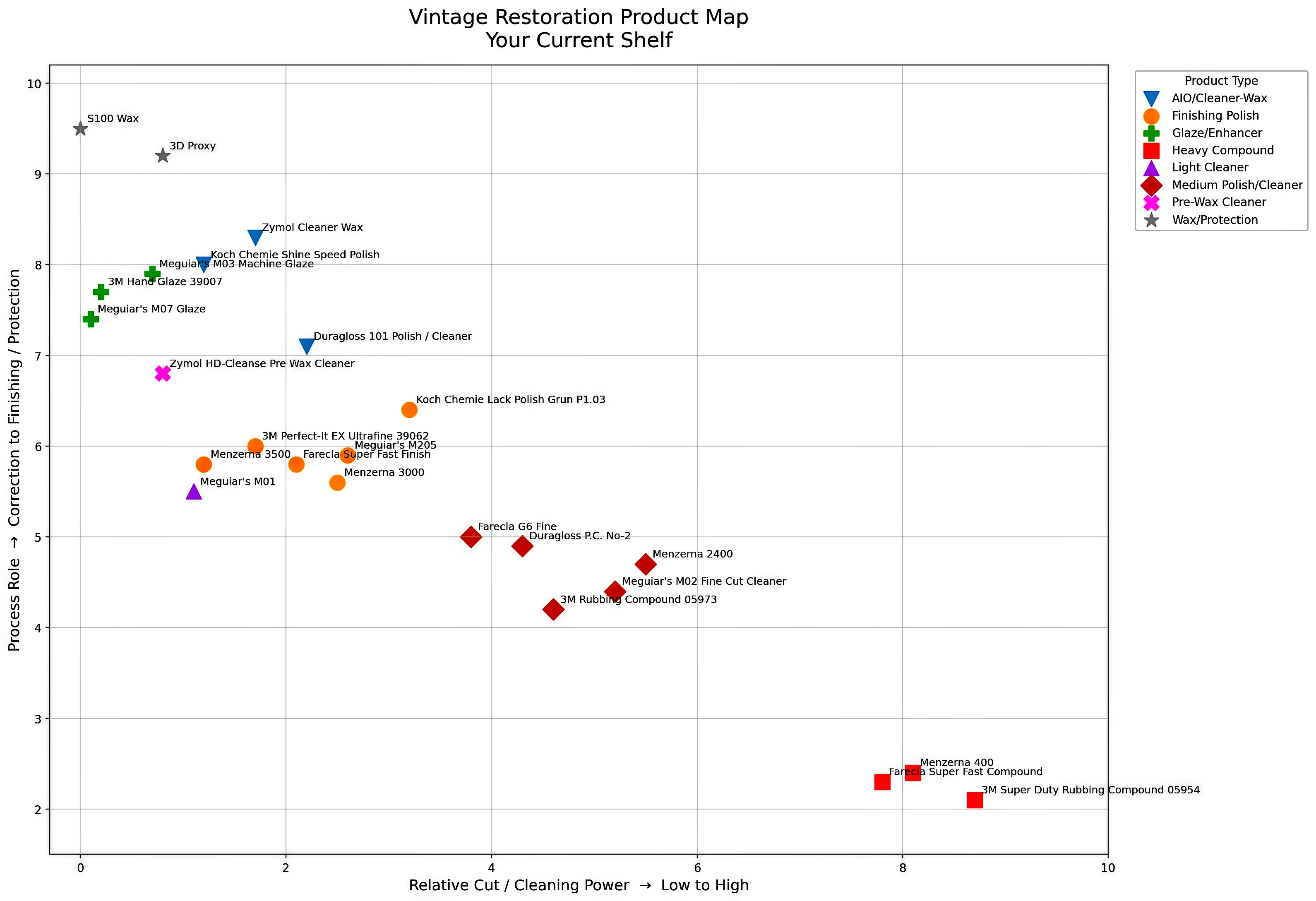

Yup, I'm so lame I produced a chart showing how products plot relative to cut and protection.

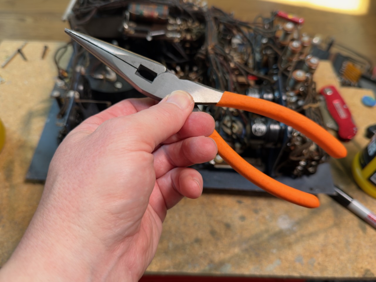

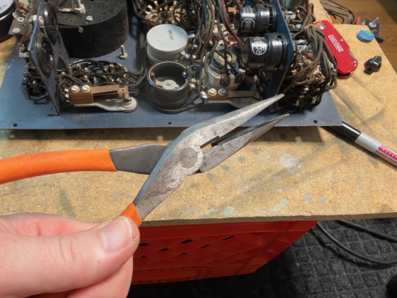

I decided to show some love to my favorite set of tools - a 35 year old set of Craftsman tools neon orange handle set.
This is just one of them I was able to clean up using a heavy rubbing compound, then a medium compound, then a semi fine compound finished with a sealant wax.
Before and after pics. took about 8 minutes using my FLEX rotary polisher with a course dense open celled foam pad.

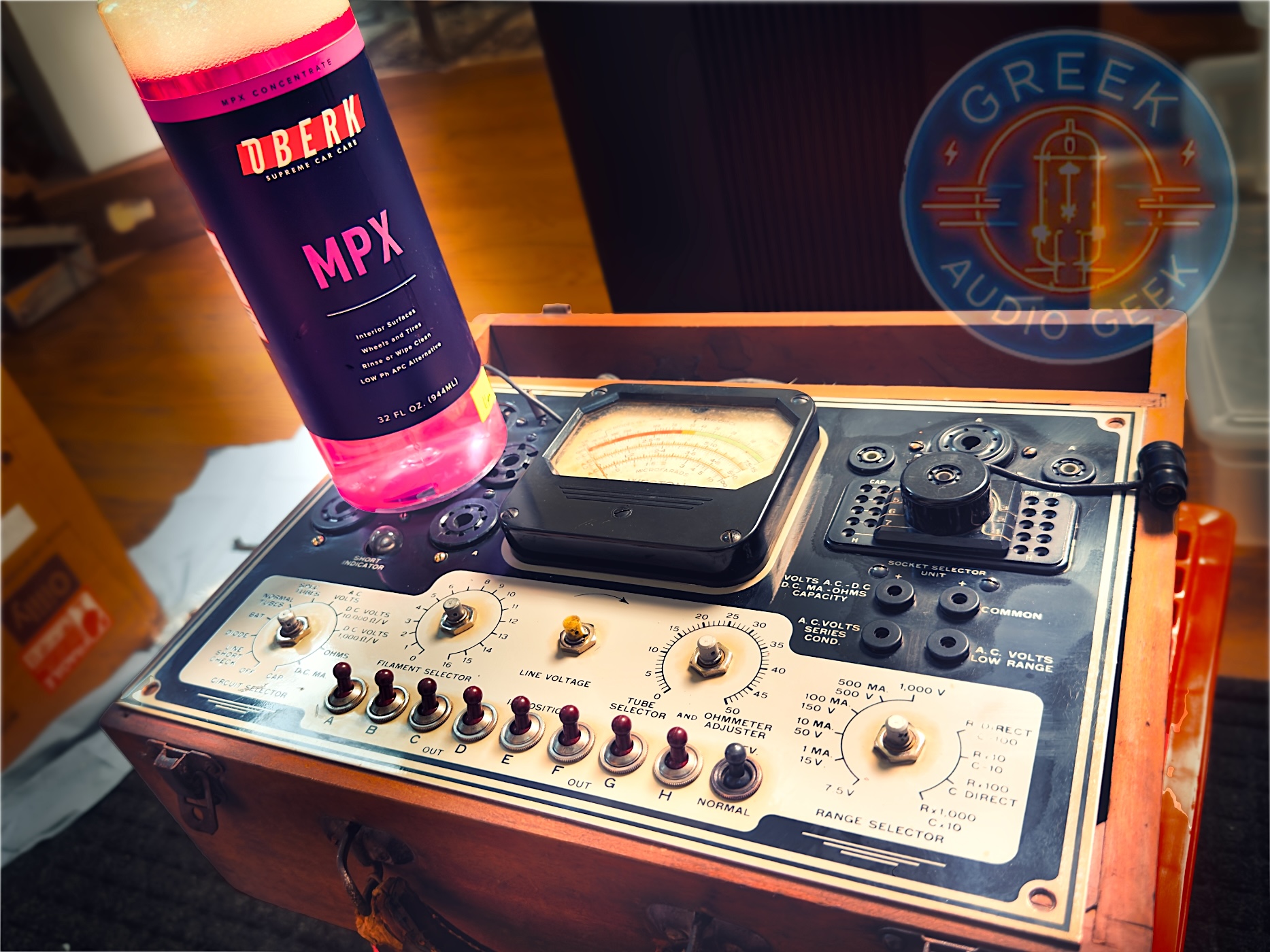

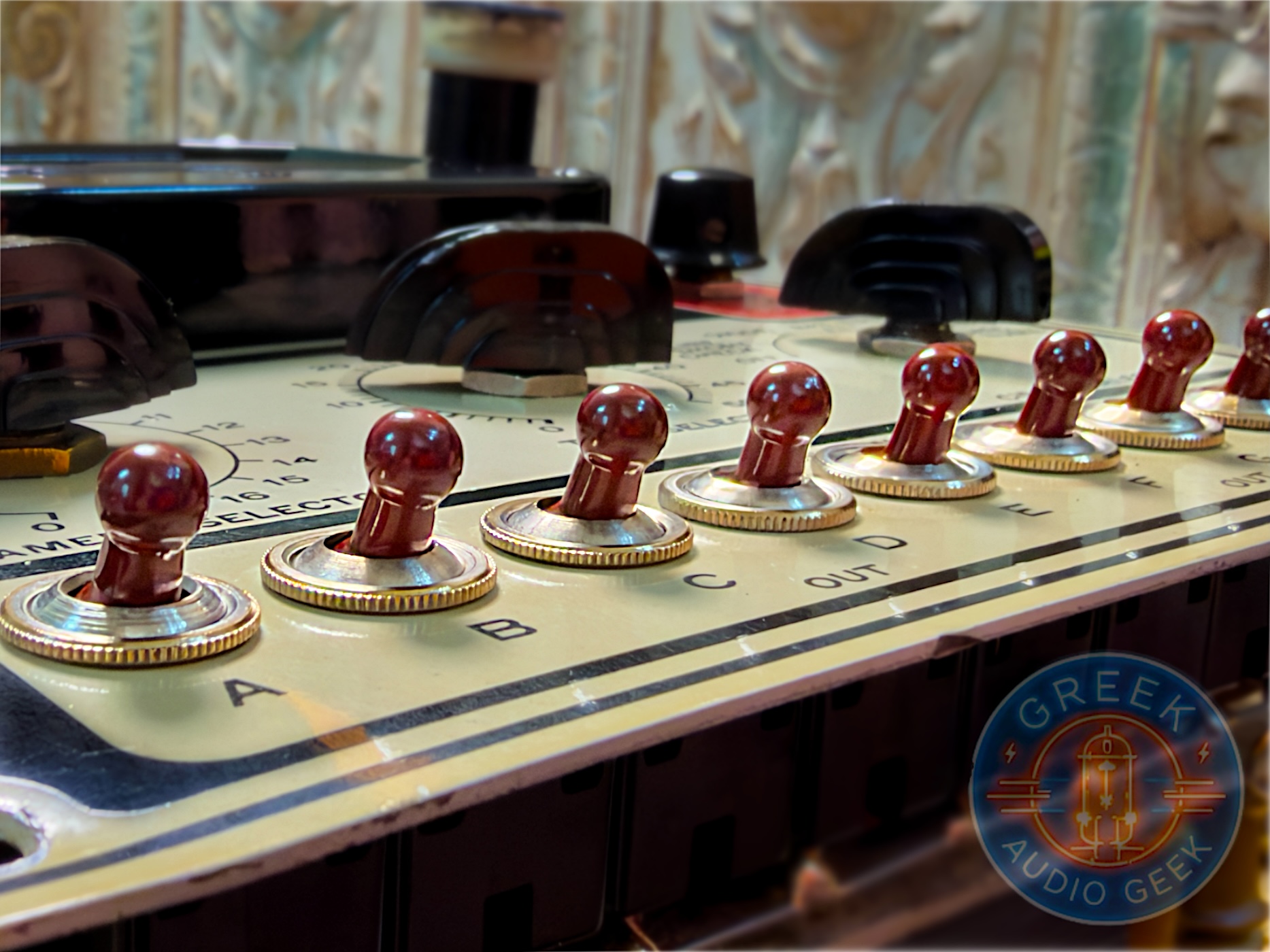

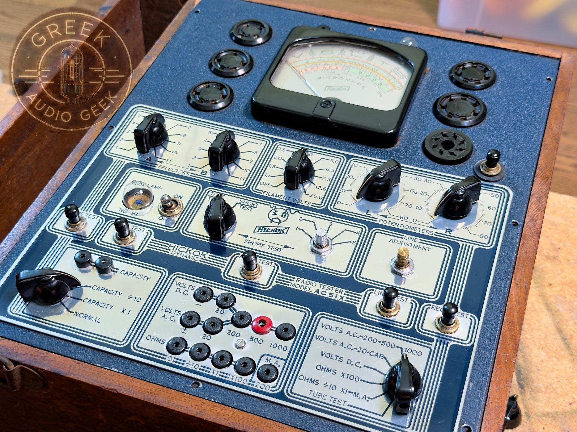

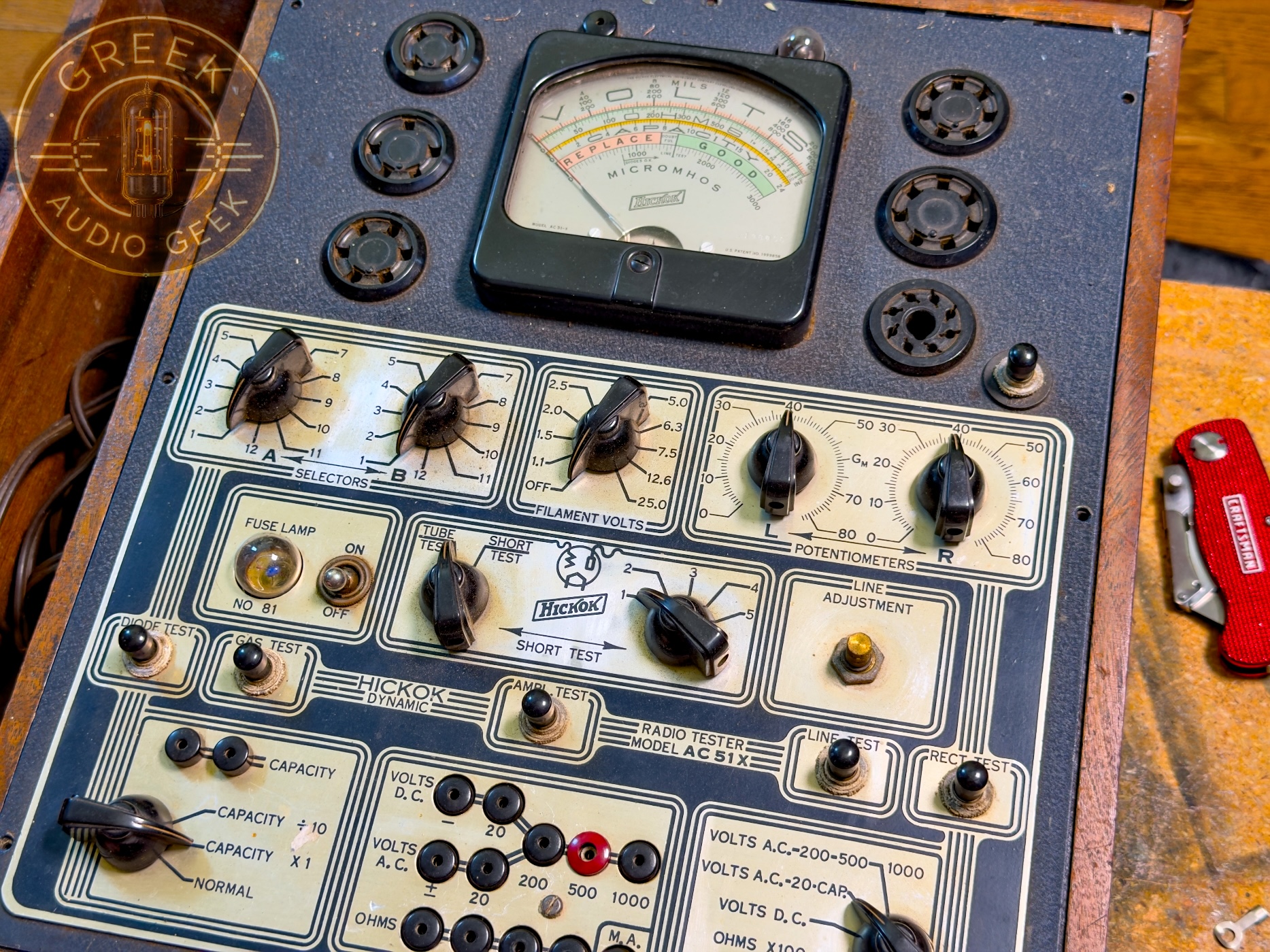

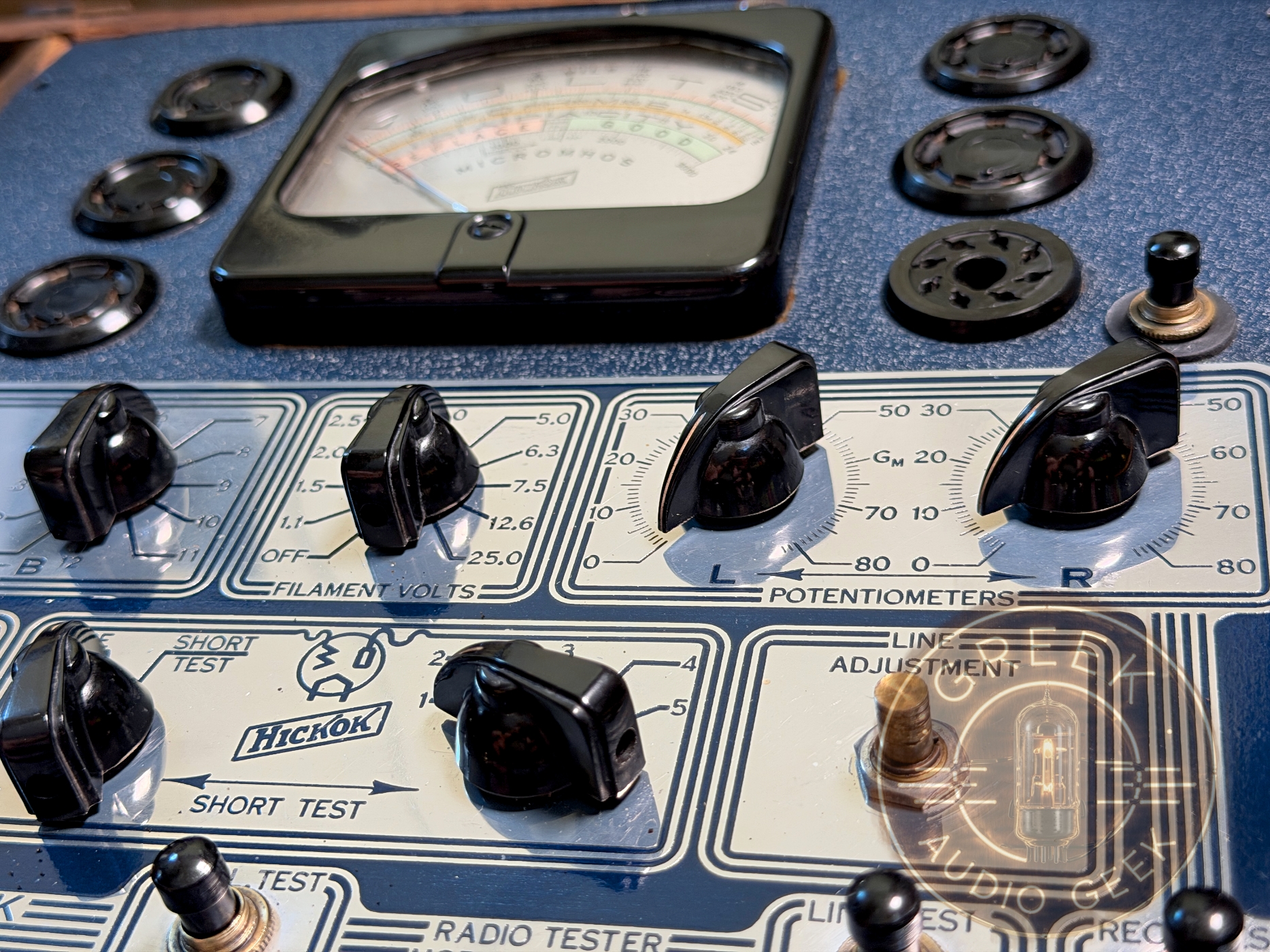

Here is a before and two after shots.
Took me about 8 hours just for the faceplate. I'm going to work on the wood case and then the internal electrics next.
I filmed much of the work and will be putting a video together and also writing up a bit of how I did this and what I used on.
The faceplate is untreated bare aluminum which adds some seriously challenging dynamics to work with not normally faced.
Not only is is SUPER sensitive to scratching - as in even wiping with a soft cloth with too much pressure will scratch it - but most chemicals will react in a negative way with bare aluminum and destroy it in an instance.
I tried over 11 cleaners in test spots to find the one that worked best in terms of helping to take some of the gunk off before I used polish since polish would only spread the gunk.
I tried a microfiber cloth (too weak with no cut), a non-scratch pad (which ended up scratching), and finally settled on cotton cloth and spent hours with Oberk MPX rubbing away the grime.
Then came the trial of various polishes and mixing them with the pads. That's right - it's not just a matter of choosing the right product, but you need to choose the right foam pad to go with it that is just as important as choosing the right product.
For instance, do I want a stronger polish with a more gentle pad? Or a weaker polish to protect the aluminum chemically with a more aggressive pad that may end up scratching it?
Not only did I take off every knob to clean and hand polish. I took off every retraining nut underneath to hand clean and polish just incase you ever caught a glimpse under the knobs- it would look good.
Thus goes the part I love the best: the challenge of overcoming 90 years of history robbing grime.
Missing in the photo are two knobs I am repairing before replacing.
