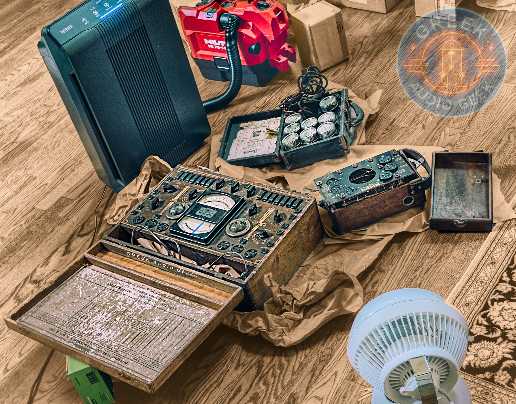

Sometimes, before any real restoration work can even begin, you first have to get rid of about 90 years of smell. 😂
One of the latest arrivals has an unbelievably strong old cigar odor — strong enough that I had to bring out the heavy artillery.
Whenever one of these old pieces arrives, I immediately open the shipping box and get all of the packing material and shipping boxes outside. Cardboard, paper, foam, and wrapping material absorb decades of odors and can make the whole room smell before you’ve even touched the equipment.
Usually, an overnight blast from a fan on the unit is enough to make a huge difference.
Not this time.
If you remember, I purposely bought some of these rougher pieces as a test to see just how far we can go restoring really challenging vintage equipment.
On the smaller unit, I already removed the meter and opened up the faceplate so I could get air circulating through the inside of the tester. That’s often where the worst odors live — all of that old cotton-covered wiring, insulation, dust, and internal material has spent 80–90 years sealed up with almost no airflow.
So this one got the full treatment:
Opened up.
Fan running.
Air purifier parked right next to it.
All before the actual restoration even starts.
Sometimes restoration is polishing brass and making old wood beautiful again. Sometimes it’s trying to convince a 90-year-old tube tester that it no longer lives in a cigar lounge. 😂

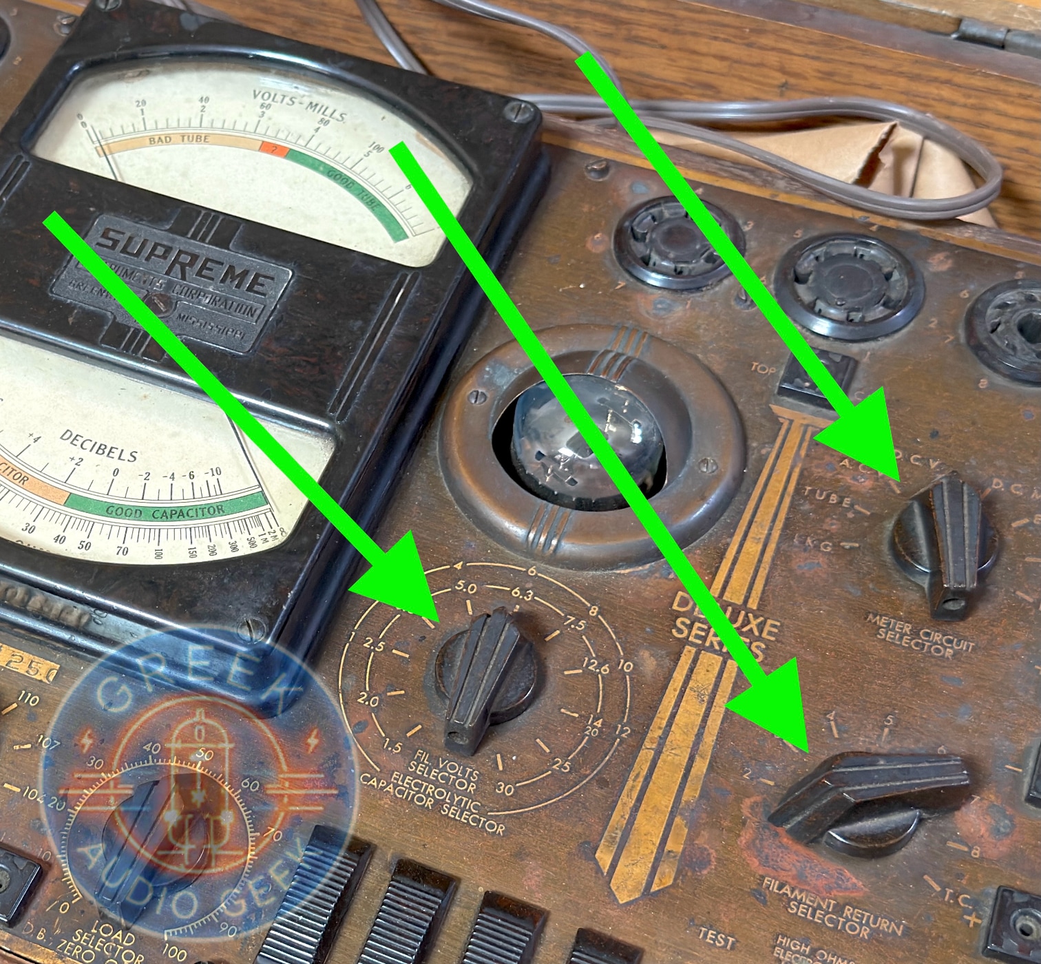

I’ve made some good progress. I’ve cleaned everything up internally and applied De-Oxit D-100 to all the switches (lots of ‘em!) and replaced the belts. The faders got D-100 follows by Faderlube F-100. The rubber was cleaned with rubber cleaner and is in good shape so I don’t think this deck got a lot of use. Really dirty switches got flushed with D-5 or CRC Electronics Cleaner.
Left channel is working, right channel is dead so I’m troubleshooting that. Chances are it’s a switch or a trim pot or a wire that has come loose. The transport is working well and the motor servo is stable, so that’s really good news. The rubber is unobtainium though there are some rebuilders out there.
I haven’t even started to think about electronic component replacement. Since it’s a single rail design this thing is chock full of aluminum electrolytics. I want to get it fully functional first and see how it performs. Then I’ll see about replacing caps. It is, after all a cassette deck with all the limitations that come with that format.
Those Tantalum’s are pesky time bombs. I’ve seen the aftermath of a PWB that burned up as a result of a tantalum cap fire. They sure had low ESR over a wide of frequencies though, so they got used in a lot of power supplies.
The cleaner/restorer that Michael recommended arrived today so more case cleanup is next in line.

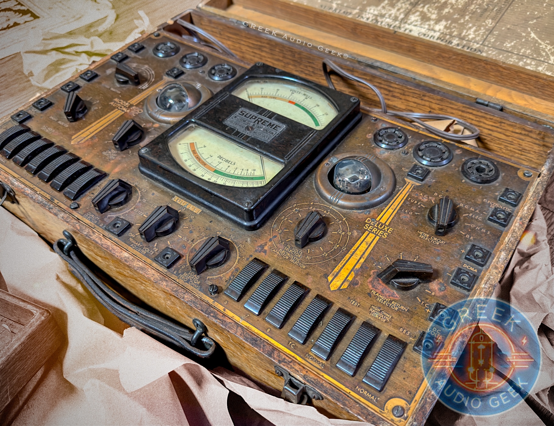

This is going to be a NEW kinda challenge.....the face plate is brass.
That basically takes almost ALL the cleaning and restoration options off the table.
I can't wait to tackle it!

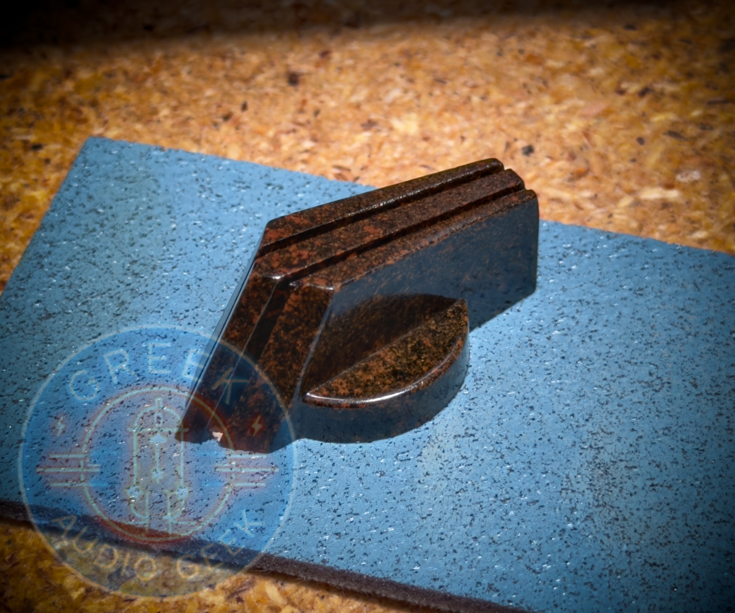

After 73 - yes 73 experiments I FINALLY found a way to restore these 90 year old knobs.
I've tried different kinds of polishes, grits of polishes, brands of polishes, wax/polishes. sealant/polishes, waxes, sealant, oils, sandpaper up to 12,000 grit, different types of pads and cloths, basically everything but a one handed stand.
FINALLY figured it out on #74!!!!

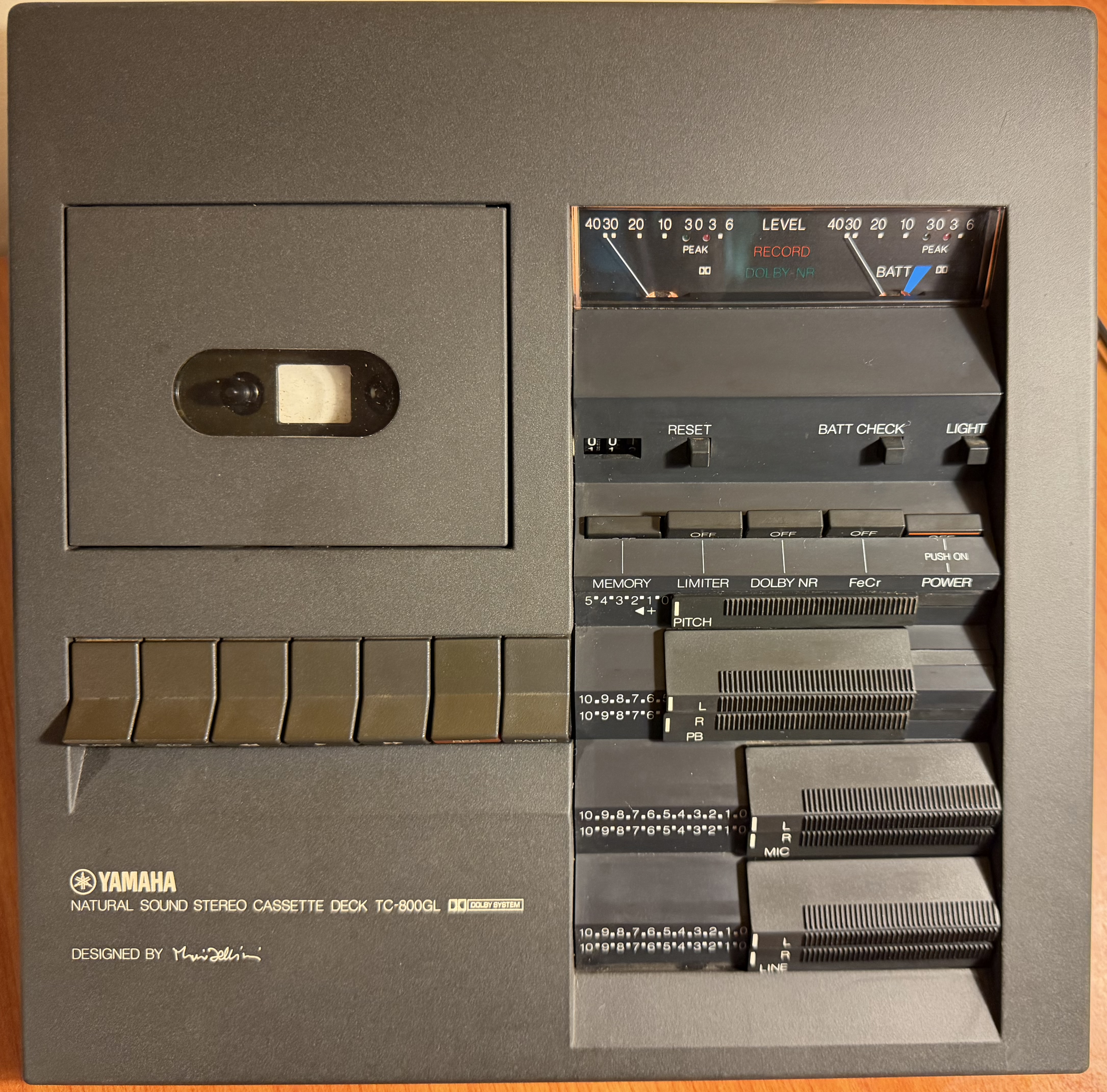

I’m almost done with the cosmetic cleanup. A bit more detailing around the sliders, a bit more to tidy up but the old bird is looking pretty good.
There are only a few small actual plastic scratches and they are not very deep or noticeable. Most you can only see when the light is at an oblique angle. For something plastic and over 50 years old that’s a minor miracle. I’m very pleased with the condition of the casework. It’s good enough for me to complete the restoration.
I cleaned the transport and all the rubber components. The rubber looks good and the transport works properly, including g the motor and servo circuitry.
I still have a lot of electrical troubleshooting and alignment to do. I cleaned all the switches and pots and I have both channels playing, but the playback gain is low. As Ralph mentioned there are lot of electrolytic caps that are questionable due to age.
We are at our summer place and I don’t have any test equipment here. So I put the deck together and am listening to some old mix tapes for the fun of it.

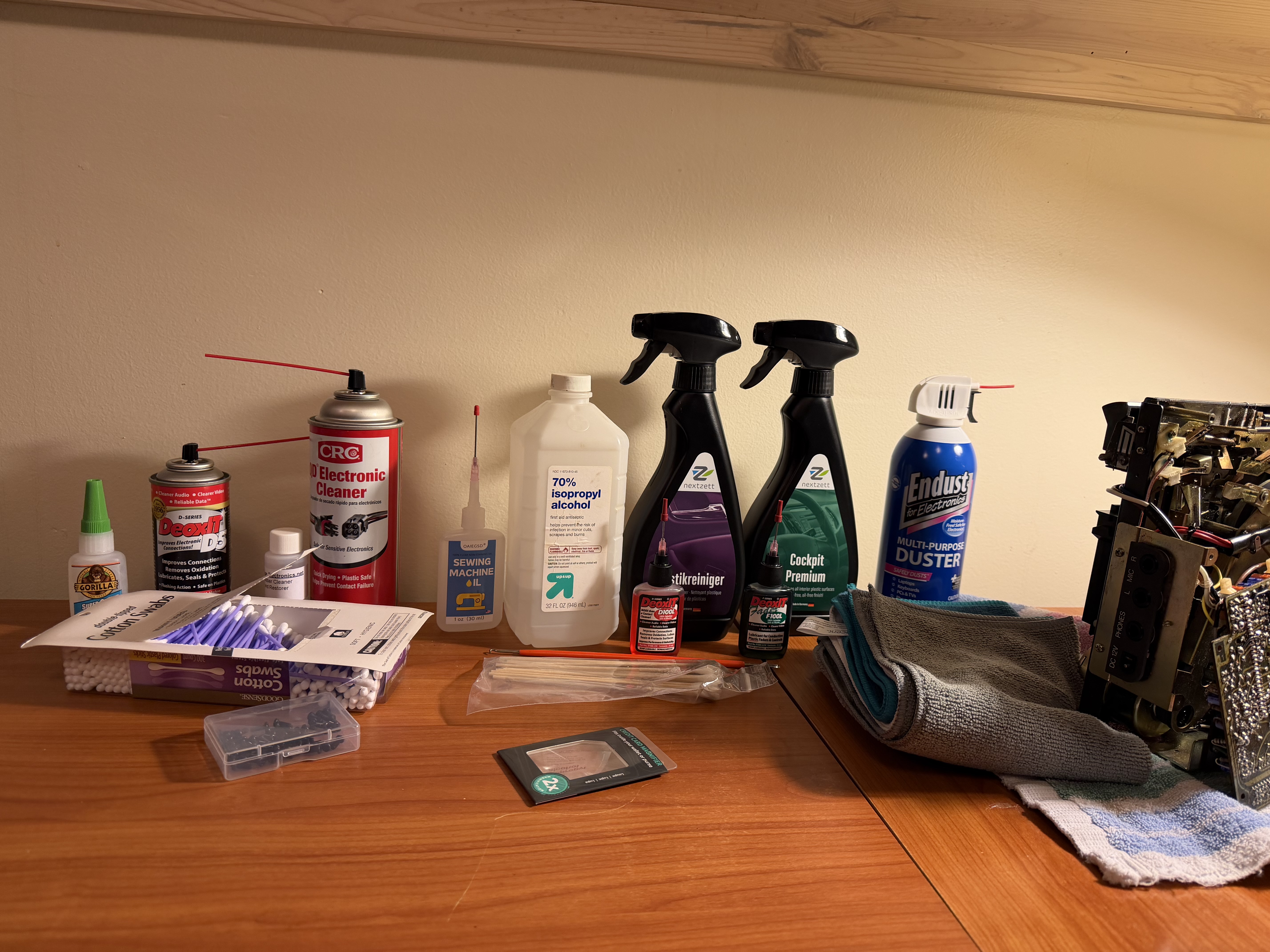

Here is a pic of all the goods I used to clean up this deck. Not shown is the M3-0.5 tap I used to clean up one of the brass inserts that had been abused.
There was a lot of schmutz of uncertain origin that the Isopropyl alcohol dissolved. After that I tried the two Nextzett products. Cockpit Premium is the bomb. Nectar of the gods for plastic.
Switches got flushed out with CRC cleaner, then D-50, then D100. Faders and pots got D100 then F 100 Faderlube.
I went through several hundred cotton swabs and dozens of cotton balls
The end result looks pretty good.
Those are beautiful! Are they Bakelite?
I’m impressed, Michael. I’m pretty sure that I have never seen a more stark example of before and after restoration. Well done.. (y)

Thank you so much. I've probably got 15+ hours in time spent on experiments on that one knob. LOL

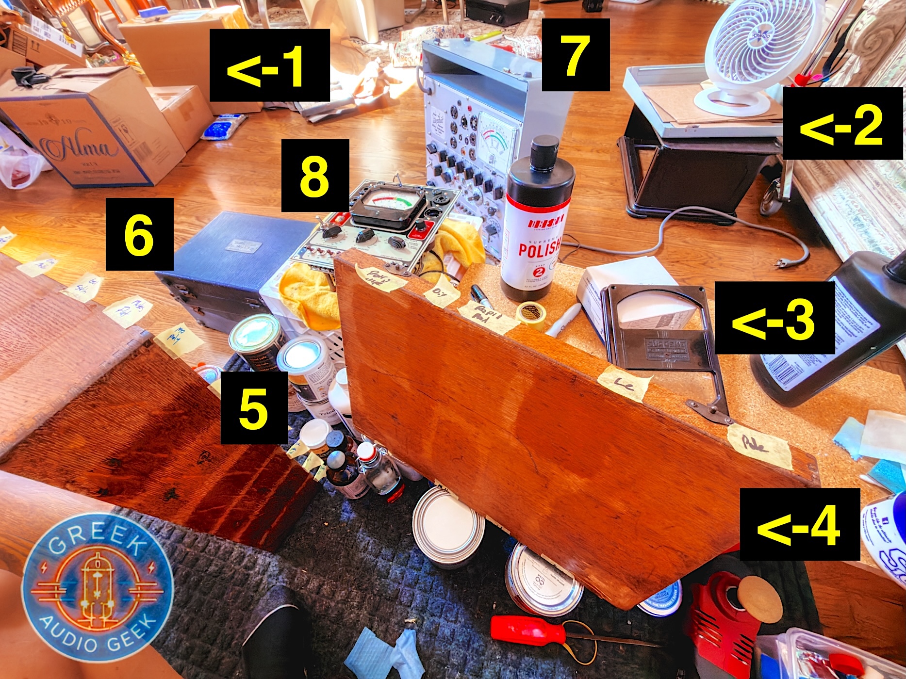

A picture of the chaos my wife endures here. This is our foyer entry way.
1) More deliveries I've yet to open containing tube, test gear to restore and gear to review;
2) Wood if the frame I'm going to restore from my 1925 Grebe MU-1 Radio that is currently acting as the fan stand;
3) the meter cover from my recent test mule Supreme 500 in which I'm testing 11 different ways to restore the lustre of that weird finish it has;
4/5) the wood case from the Supreme 500 I am trying a new 1/2 restoration process that involves only cleaning the wood with lacquer thinner and steel wool which removes most of the grime and a bit of the finish but still leaves much of the original finish intact. Then rather than sanding down to bare wood like I have in the past, I apply wash coats of a new finish to help restore and revitalize the original finish. On the two pieces of wood here I am trying 35+ different finishes.
6) 2 more vintage pieces I haven't even opened up yet.
7) Fully restored Hickock 750 just waiting to receive some tube testing love;
8) My restored Weston 771

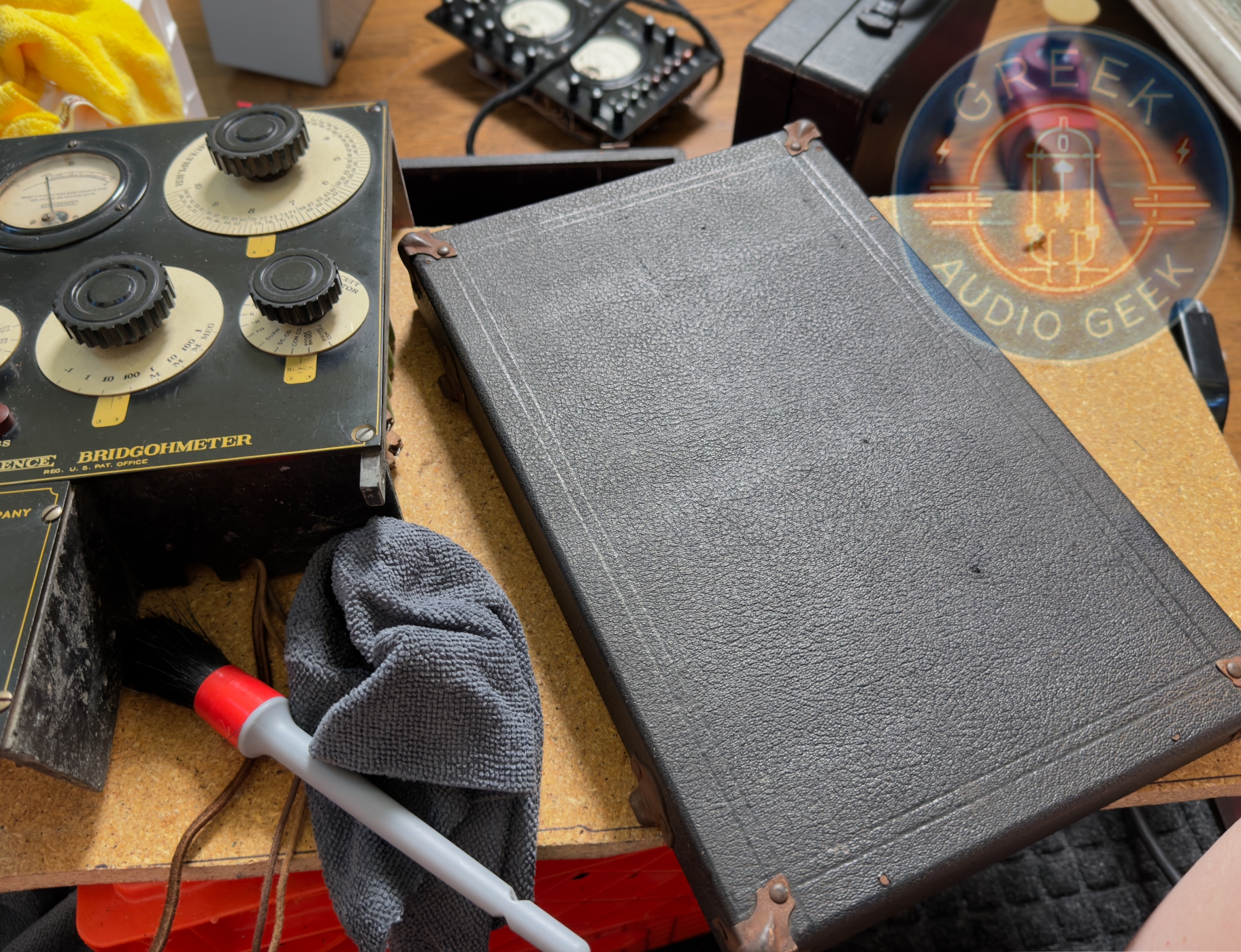

11 layers of cleaning to get this 1929 Jewell tester looking like it does now. Also note the original 1929 battery in the upper left hand corner.
I carefully cleaned the batter then applied a museum wax to protect it.
Also next photo is the original caste I cleaned and restored to original look (no fake gloss).
The interior lining was carefully cleaned by patting with a gentle carpet cleaning that is also a germicide.

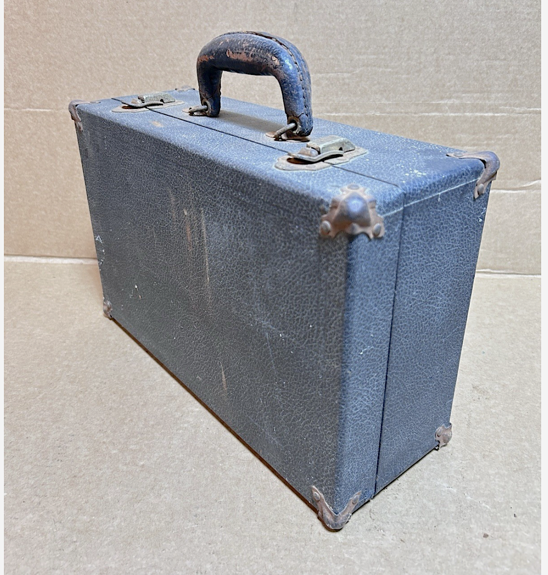

Got this in today and it is filthy and it stinks like mildew (it's from the 1930's).
So I took it out of the case, vacuumed the case, did a pre-wipe with an anti-bacterial shampoo then hit it good three times with the brush for agitation and some special cleaner that is designed to kill germs and remove odors but is designed for carpet and vinyl.
I'd spray it on, agitate with brush into a lather, then wipe off. from spray on to wipe of was about 15 seconds as I didn't want it to sit on too long and seep under the covering and risk warping / lifting.
Now I'm letting it air out over night.
Before and after:
