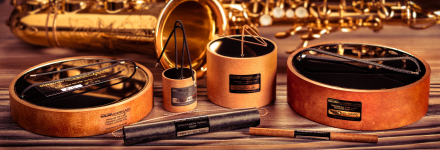

I like soft dome tweeters and paper cone woofers... and also planar magnetic tweeters - I'm listening to 12 of them right now in a pair of Line Arrays. With the resolution from the planar magnetic tweeters I have and the likely resolution from that tweeter in the Gobel Divin Monarque, I suspect it may very well like some copper foil too. At a minimum, I've found bypassing the tweeter caps in any network with a .1uF Duelund CAST-PIO cap is helpful. "Organic Detail". That's something anyone can do, if they can get access to the network for their speaker. It's an easy thing to try. A picture of the .1uF caps I use for bypass are below.
