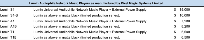

Lumin MSRP Price List

I wonder what they did to the original Lumin to justify the 2,5x price increase. I still remember lumin was $3k, then went up to $6k.

I can ask Li, but I'm not sure. I'm trying to talk him into some sense with the pricing on the S1. Wish me luck. $9200 seems like a sweet spot to me. $15,000 seems high.
