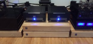

Hi Mike,
I am using a Cary SLP-05 preamp with the Nords. The Amps are on the floor on maple block. My setup is a bit weird as I have to accommodate HT in the same room/setup.
The buzzing noise is coming directly off the Amp chassis and not through the speaker. Its like a 60Hz buzz from transformer and I can hear it when I have 1/2ft from the Amp.
I am yet to troubleshoot it since I wanted to check with other users if this buzz is normal or not. Now since you and other confirm that they don't hear in their system, I will start trouble shooting it, like you asked.

Devg, very nice system you have.
