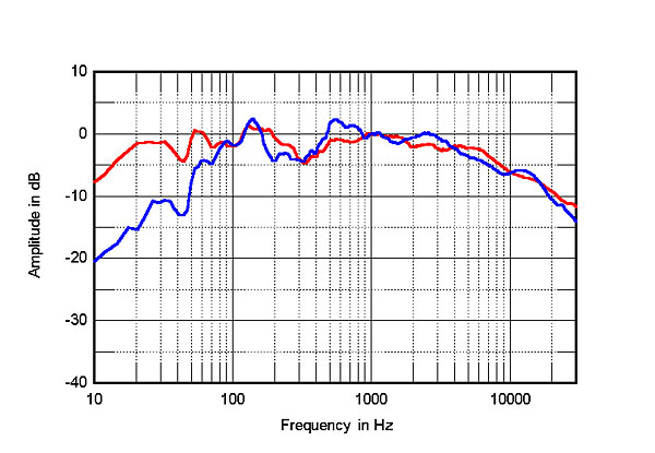

Fig.5 Magico S5 Mk.II, spatially averaged, 1/6-octave response in JA's listening room (red); and of Crystal Arabesque Minissimo Diamond (blue).
