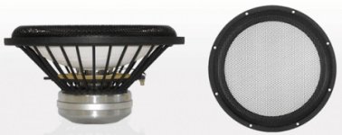

Considering Magico prides itself on developing all drivers in house I'd be surprised if they leveraged drivers from any vendor especially for their new flagship M9. My information comes from the Magico site. The M9 - A Revelatory New Flagship Loudspeaker — Magico Loudspeakers
the 11" Magico bass driver (2 per tower) has lot's of common design attributes to this Accuton 11" bass driver (of which there are 4 of in each of my speakers).
Accuton S280-6-282 11" Sandwich Cone Woofer
likely not an accident. my MM7 passive towers are 97db efficient; if they only had 2 of these drivers they would be 94db efficient. and the M9's just happen to be 94db efficient. imagine that.
find another 11" woofer that covers 30hz to 250hz that is 92db efficient. you won't find one. only this one. which is why Magico choose it. then they modified it. nothing nefarious about it. i can tell you that no dynamic driver speaker can do mid bass like my speakers. and this driver is key to that. no crossover in the power range of the music. like a planar. with 4 there is little driver excursion. quite the effect. and with high efficiency you get ease in the amplifier. all around magical. Magico.
i've had my speakers for 8 years. so long before the M9's were even a twinkle in Alon's eye. if these 11" Magico drivers did not begin life as Accutons, then Magico certainly used the Accuton's as design inspiration.

Reading Magico’s and Accuton’s description of their 11 inch woofers, it appears that Magico has used Accuton’s basket, neodymium magnets and titanium voice coil in their M9 speaker. The description is identical word for word. However, the speaker cones on the M9’s are designed, manufactured and unique to Magico as they utilize a carbon-graphene/aluminum honeycomb core/carbon-graphene sandwich proprietary design. This is a significant differentiator from Accuton’s ceramic sandwich speaker cones.

... so now i had ceramic drivers from 30hz to 3khz. wow and double wow. no dynamic driver speaker i have heard can do what the MM7's do in these frequencies. ceramic is inherently stiff and light, and retains linearity and lack of distortion.
