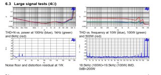

The switching noise is completely cancelled out in the amps. Show me where the switching noise is?
