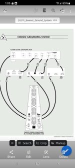

But the wiring diagram in the Altaira documentation shows it being grounded to the power distributor.
So in practice you have found that Altaira not connected to Everest sounds better than connected to Everest GP-NR? If so that would seem to fly in the face of the wiring diagram.
So this is true even though the M-10X does have a signal ground post? Interesting.“If they don’t have the IEC ground pin then they cannot be grounded by way of Altaira, at least conventionally. The continuity work sheet has this ground pin question as one of the first. So for now, Luxman is a no.”
So the short story is: signal grounds do not get connected to Everest. Component signal grounds get connected to Altaira, and Altaira gets connected to Everest.
