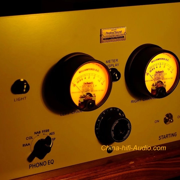

I have been using the Line Magnetic 129 phono for a few years.I dont own any early pressing to utilize the EQ Curves but do play around when playing Live LPs
Re: Phono Stages with selectableRIA EQ Curves (A, Decca, Columbia, etc.) ?
Looks cool Stump. can you use the different curves as eq?
