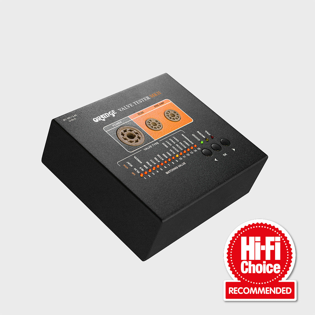

I wonder if this tester is good enough to check the health of the tubes it is capable of testing?
For basic testing is sure it. It looks to be a basic go/no go tester meaning it will tell you simply tell you (generally) if the tube is OK to use or not.
It's great for the person who simply wants to be a responsible tube owner but not get into the nitty-gritty of testers and such.
I know for a while Orange was having some issues with their testers not breaking, I don't know if that has been resolved.
I think the MKII version cleared up their issues.
