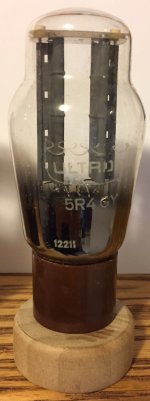

Yeah those are nice rectifiers. I have a couple. Labelled Haltron and Ultron, but by looking at the construction I think they are made by Brimar.
