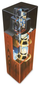

Which KEF 107 are we talking about - this Reference 107, or the more recent but not top-of-the range 107?
