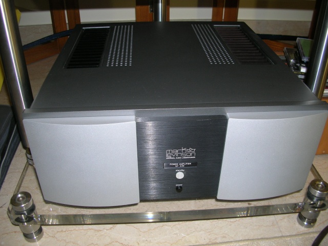

Here are a few reasonably priced power amps that will drive the Maestro's:
- AVM SA8
- Audionet MAX
- Symphonic Line RG7 Reference
- Audionet AMP
- Electrocompaniet AW 400
- Musical Fidelity M8 700
- Mark Levinson N0. 432
file.php
- Krell Evo 302
