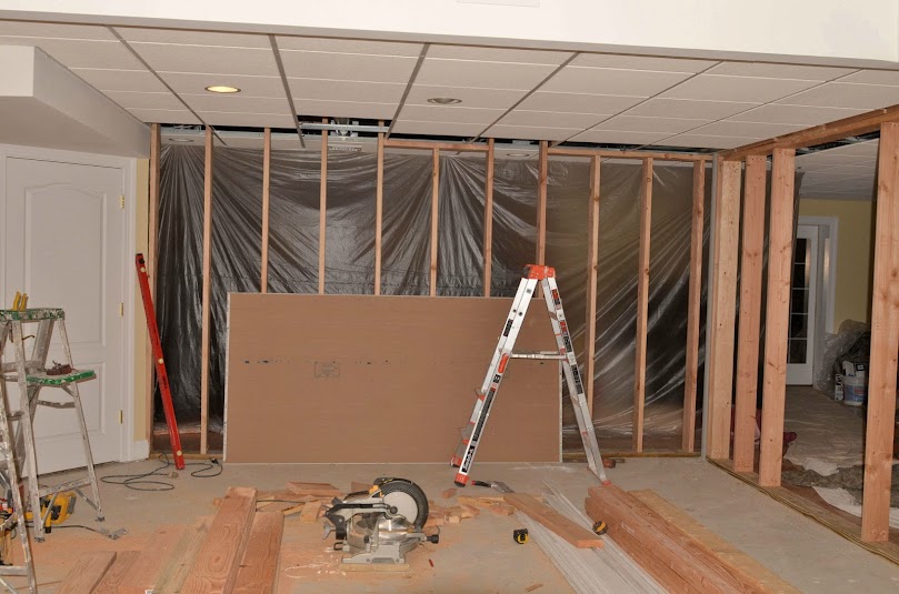

Due to my loud music playing in the family room, my family subtly suggested I really might enjoy listening to music more in the basement.:dry: We have a finished basement, but there was no real good listening area, let alone room. So talked to my wife and got the ok to tear down our TV area and build a pretty dedicated listening room.:inlove:
Before we get to the pics, I just wanted to give a big heartfelt thanks to Jeff from A/V Solutions. I just mentioned that I was going to be build a listening room, and the next thing I know we're on the phone for hours with Jeff recommending construction materials and techniques for proper acoustic control and isolation. I think I followed all of his suggestions here and I'll point them out as I go through the pics. Jeff, I couldn't have done it without you, buddy! Your advice and friendship is invaluable!:heart:
This project started a few weeks ago. But instead of showing pics in 'real time', decided to compress the time and show you in a few stages. The room when completed will be approximately 17x24x8.5-7.5. There is a dropped ceiling due to duct and pipe work.:(
First, this is what it looked like before construction started:
Tear down the walls, open up the space, and construction begins:

Per Jeff's suggestion, I used 2x6 instead of 2x4 studs to put R-19 insulation for better sound isolation.
and the walls go up...
Note the R-19 insulation in the middle of room...
Insulation is in. Time to close up the walls.
But first, another tip from Jeff. He suggested I use two layers of sheetrock on the inside wall, one 5/8" and another 3/8", and use something called Green Glue between them. It's glue-like, but doesn't totally harden, allowing the two layers of sheetrock to vibrate independently from one another to help control resonances (Jeff, did I get that right?).
That's it for now! I'll post more after spackling, painting, carpet, trim, etc. are installed, and then again when I put in the acoustic treatments.

Allen,What are the finished room dimensions going to be ??
17x24x8.5-7.5. I'm not sure if that's a good ratio or not. There is some software I want to use to check what resonances I'm going to expect.

Looks awesome so far. The 5/8 and 3/8 rock with green glue is an awesome tip.
I wouldn't have thought of that, and I wouldn't want to carry the 5/8 down the stairs.lol
It gets heavy.
