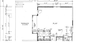

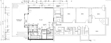

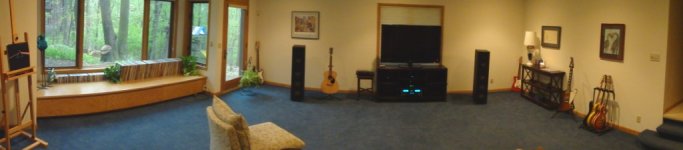

I am seeking advice for setting up my new audio room. I have attached the room’s blueprint. I’ll refer to the wall with the window seat as “the west wall”. The room is on the ground-floor, has wall-to-wall carpeting, and has 9’ ceilings.
Changes that I’m planning to make:
- Cover the entire west wall with thick curtains (we won’t be using the west door).
- Turn the closets on the south wall’s west side into built-in shelves.
- Either acoustically isolate or physically move the furnace.
- Add a door to the east wall’s opening into the hallway.
Questions:
? Which wall would you use as the front? My speakers are sealed/non-ported (Magico Q3). I like the idea of using the west wall as front, with the curtains behind my speakers. However, based on the formula that Magico recommends for determining speaker distance to side-walls, while the speakers would be equidistant from the curtain, they would be different distances from the true front wall, with one in front of the recessed window and the other in front of the (non-recessed) door. Would that be a big concern, given that my speakers are sealed?
? Should I plan on putting my components into the west wall’s built-in shelves or on a free-standing rack? My understanding is that there are pros and cons in terms of the required lengths of various cords and vibration-isolation (the built in option would be wood without integrated vibration control).
Please feel free to offer any other advice you might have. I want to make sure I have the basic things right from the outset. Then, if it seems necessary, I’ll enlist the help of a professional.
Thanks!
