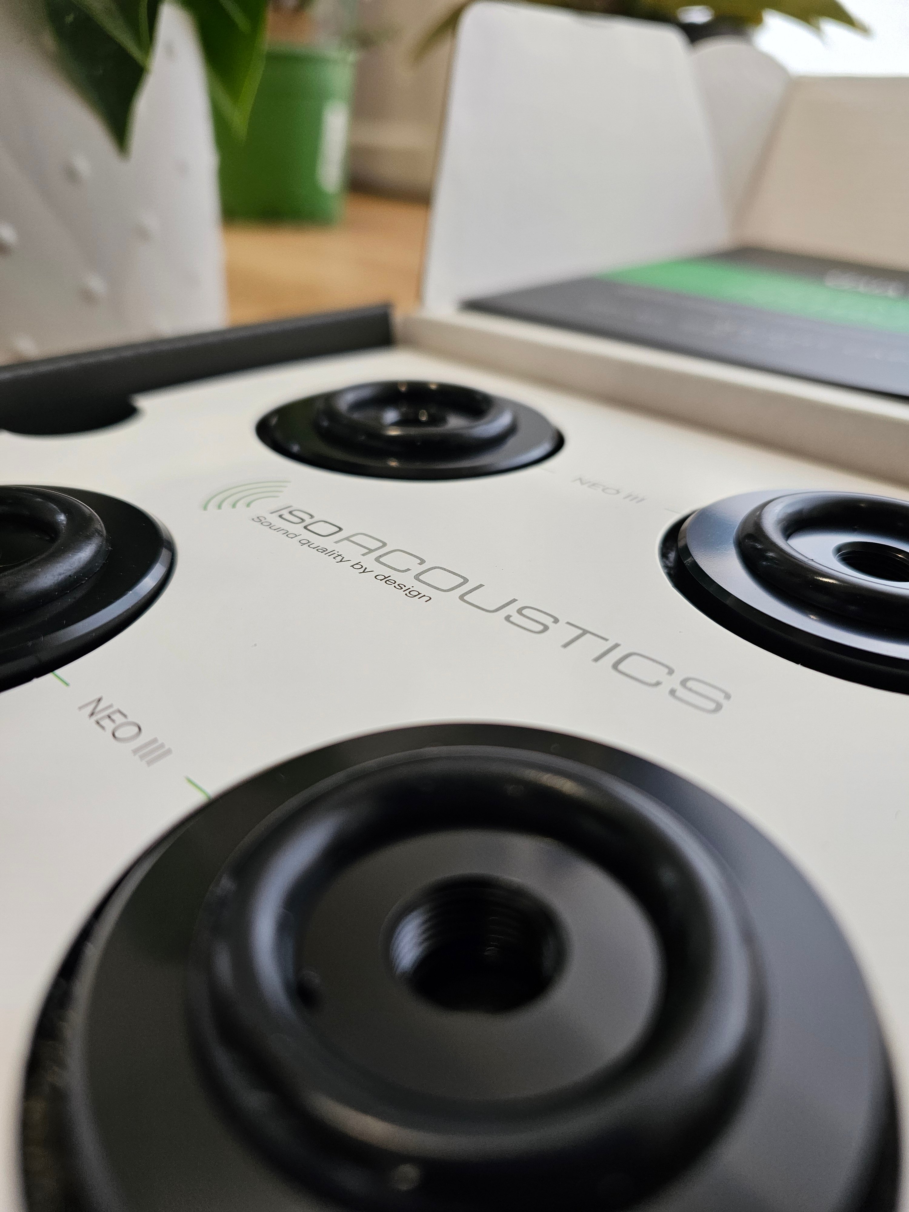

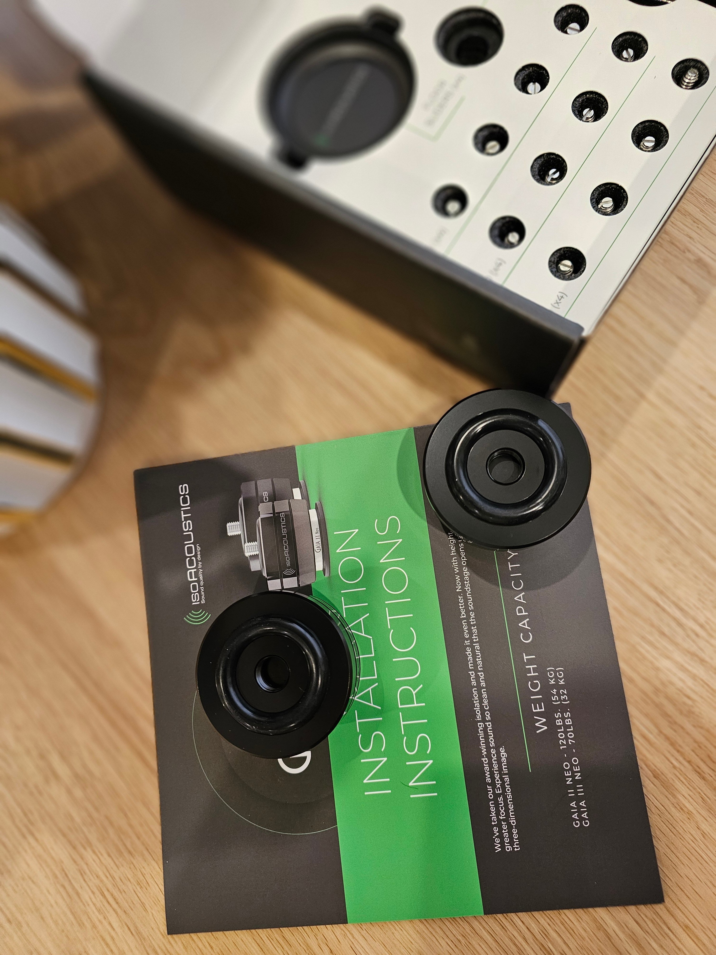

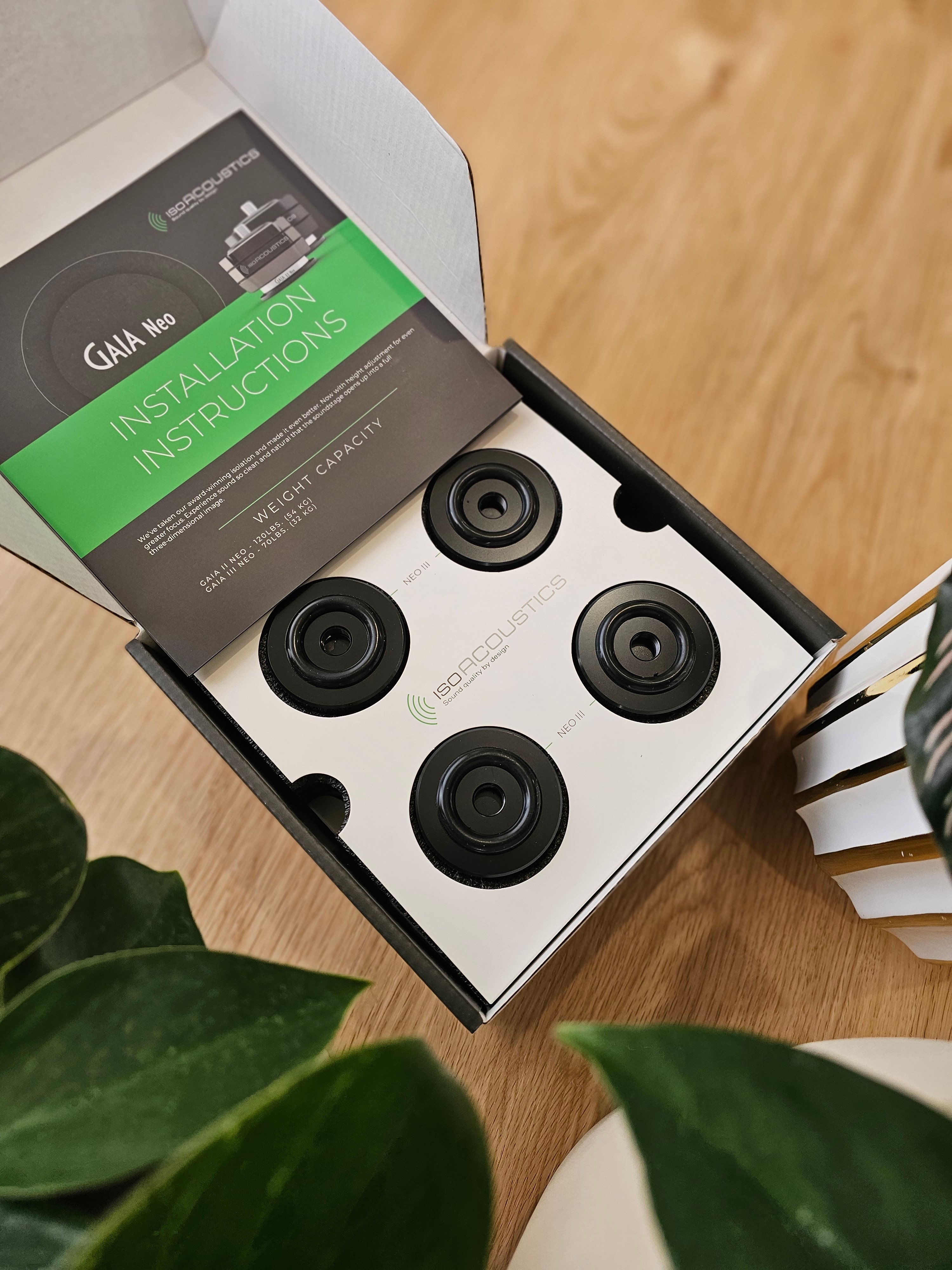

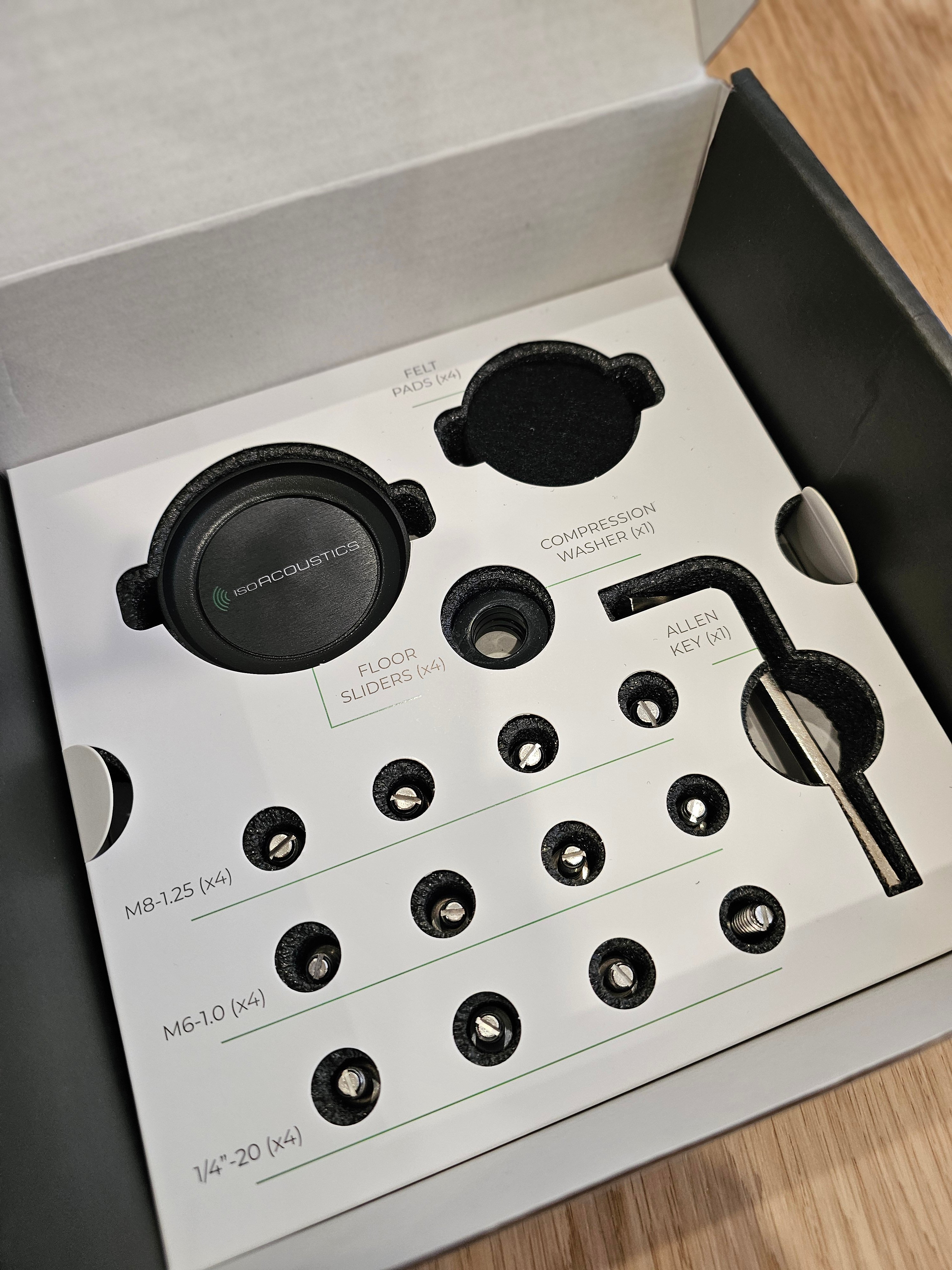

What’s in the Box:
  • 4 x GAIA III Neo Isolators (Machined Metal Housing)
  • 4 x Dual-Surface Floor Sliders
  • 4 x Adhesive Felt Pads (for hardwood protection)
Threaded Stud Adaptation Kit:
  • 4 x M6-1.0 Studs
  • 4 x M8-1.25 Studs
  • 4 x 1/4"-20 Studs
  • 1 x Internal Wrench / Hex Tool
Specifications:
  • Dimensions: 56mm wide x 45mm tall.
  • Weight Capacity: Strict 32 kg (70 lbs) maximum per set of four.
  • Height Adjustment: 8.5mm of tool-free vertical travel.

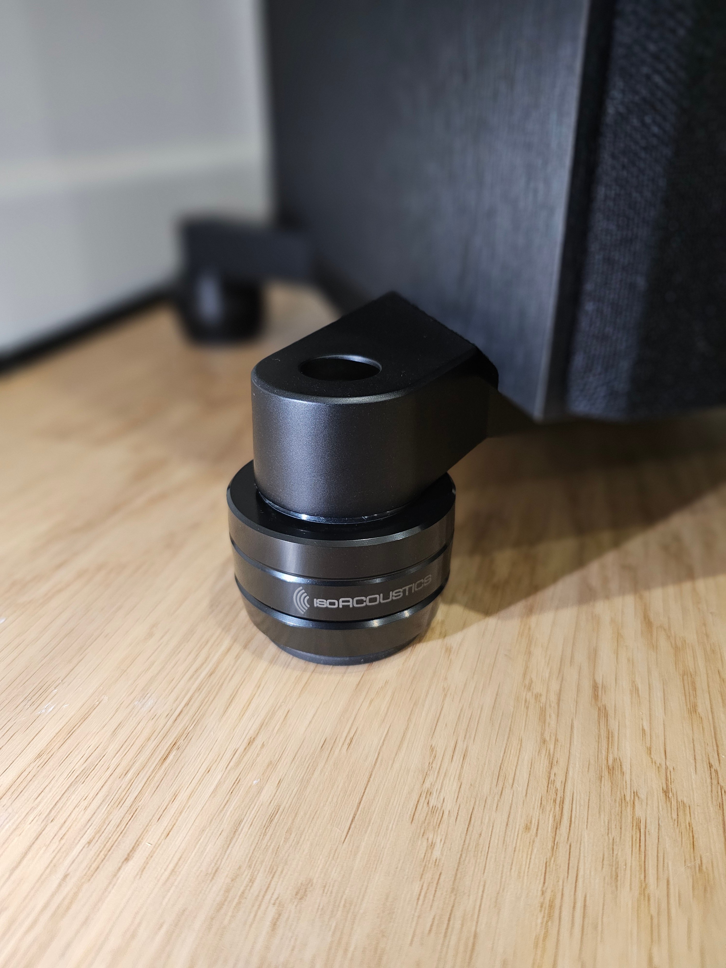

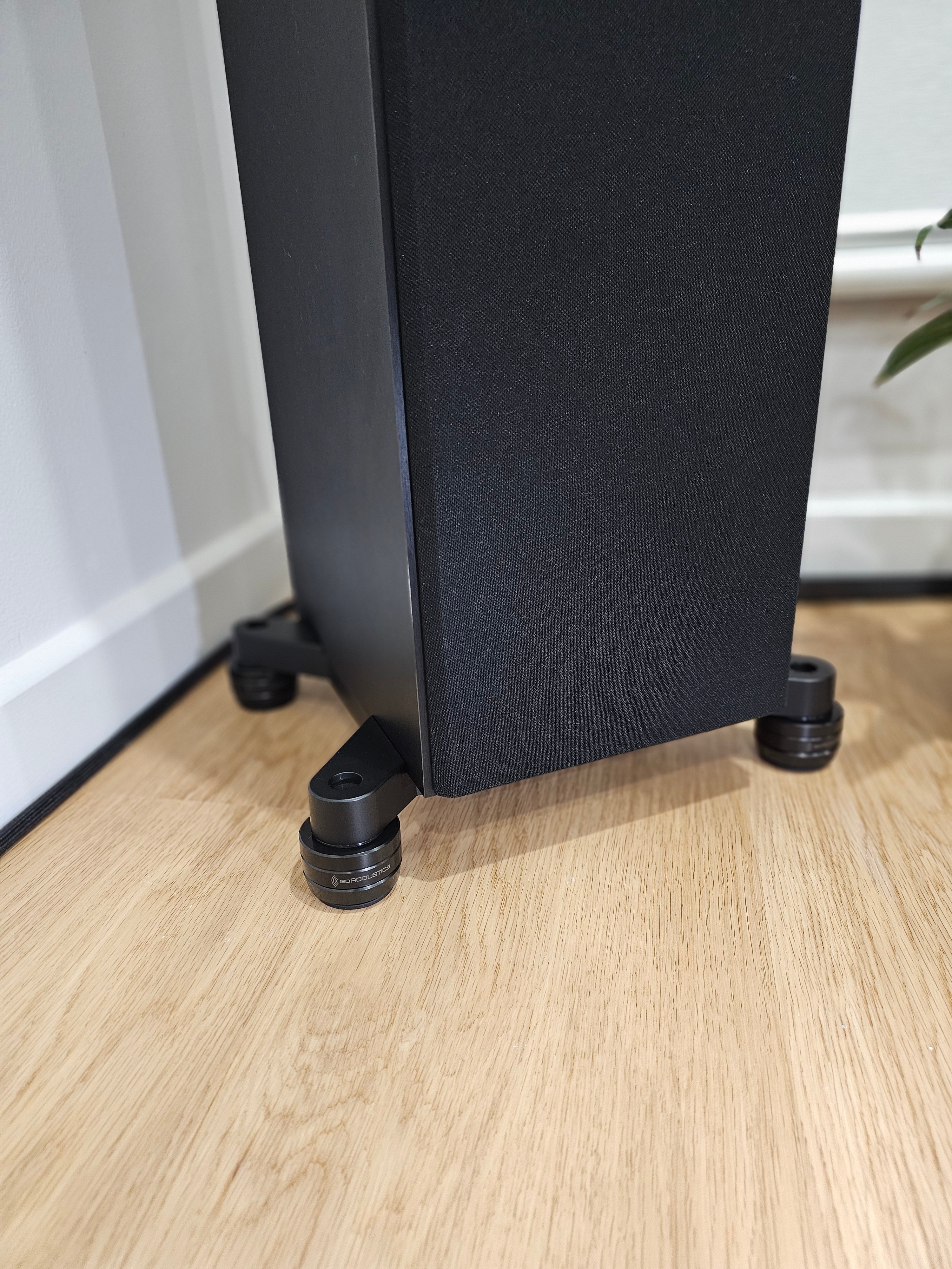

Setup & Aesthetic:

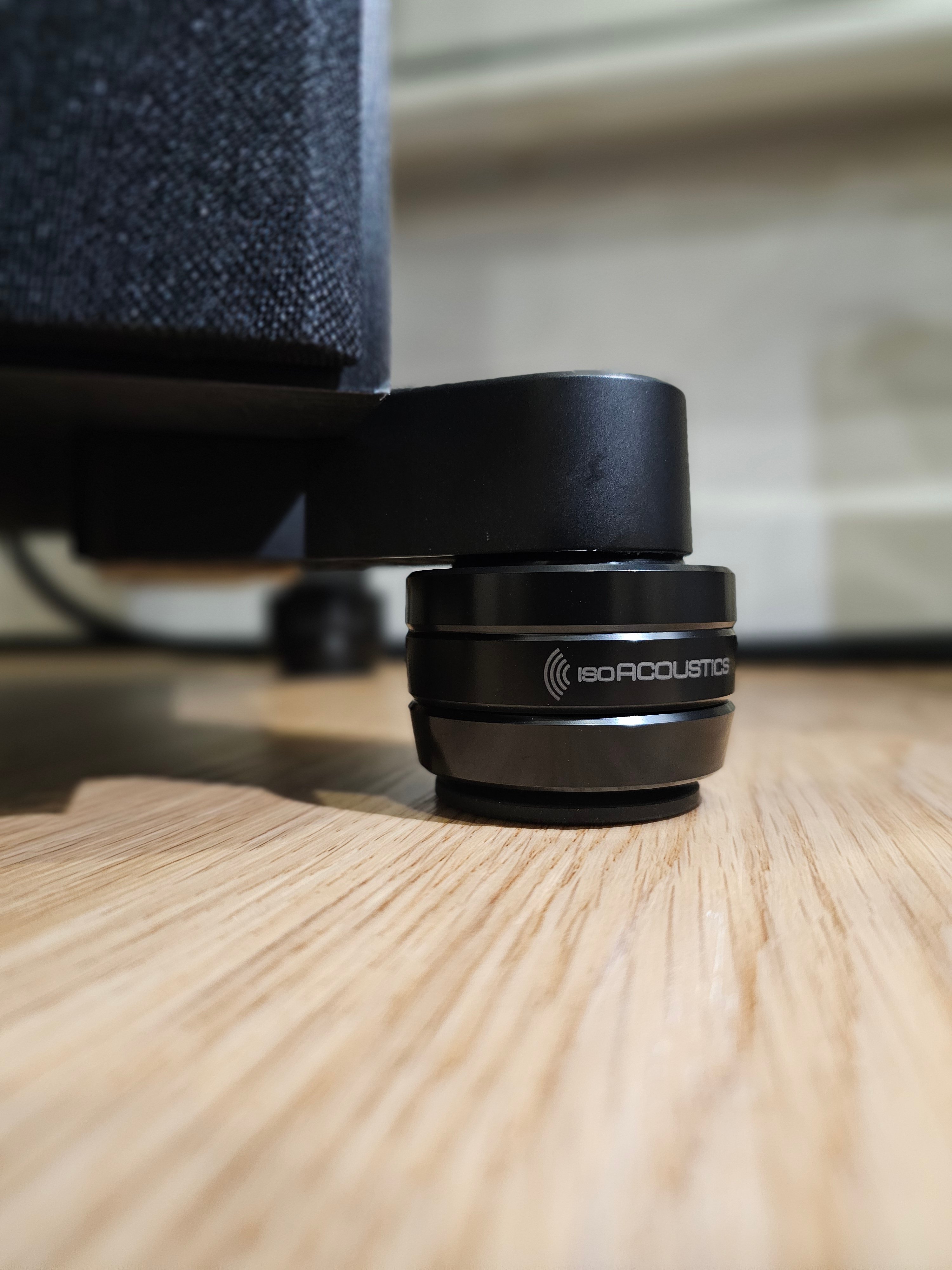

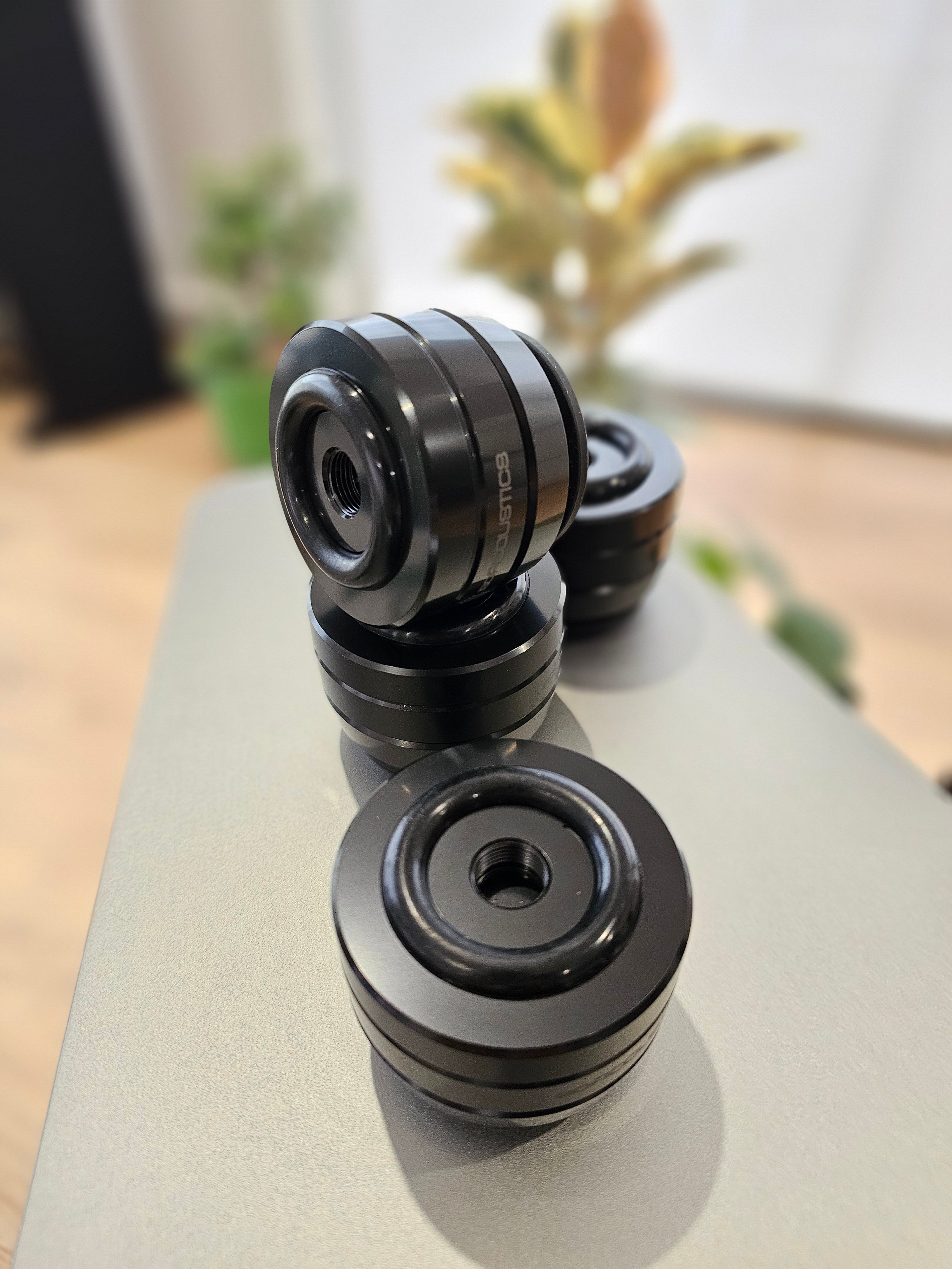

The GAIA III Neo comes in two finishes: a reflective Dark Chrome or Black. I wanted the feet to be discreet and blend into the bases of my speakers, so I opted for the Black.
One of the complaints I read about the older, first-gen GAIAs was how difficult they were to install; people disliked wrestling with tiny spanner wrenches and tedious two-part jam nuts that shook loose. Thankfully, since these are the new Neo versions, IsoAcoustics overhauled the design:
  • The Compressed O-Ring: The top of the metal housing features a thick, integrated rubber O-ring. You thread the included M8 stud into the bottom of the speakers and screw the GAIA Neo body on until it sits flush against the cabinet base. The compressed O-ring acts as its own high-friction lock. No tools needed, super simple.
  • On-the-Fly Leveling: My floors aren't perfectly level, but adjusting height on these is very intuitive. There is an independent silver lower collar ring you can twist to adjust the height up to 8.5mm on-the-fly without needing to spin the entire footer casing.
  • The Floor Sliders: Moving heavy hi-fi gear around usually risks a slipped disc or a ruined floor. Slipping the included Dual-Surface Floor Sliders under the heavy Q950s allowed me to glide them around the room to find the perfect listening spot before tilting the cabinets back to remove the discs.
While these feet raised my speakers off the ground by an extra couple of centimeters compared to the stock spikes, the visual payoff was a surprise. Even in the discreet Black, lifting the massive cabinets up on these heavy, premium pods made my KEF Q950s look less like living room furniture and more like an absolute, high-end hi-fi beast.
