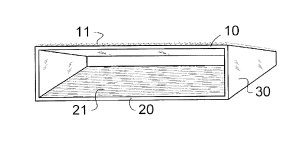

I would build a plinth that the stands sits on.....with a skirt on the front and R & L sides, the skirt on the R & L sides would be cut like a wedge shape.
Here is a pic.....a bit of modification but it would work.
Yea Jeff I like that, I got all this leftover clear maple ply. And I have a million sets of rubber feet around(every time I see some I buy em). If I put my laser level beam across the floor, I could probably get a accurate read on the slope then make a nice stand for my stand. Lol.
