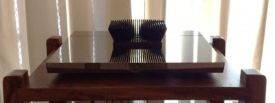

I have a couple of large heatsinks which virtually cover the whole top of the unit. I'm not using them right now but did in the summer. The fins were pretty warm to the touch so I'm guessing quite effective.
