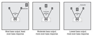

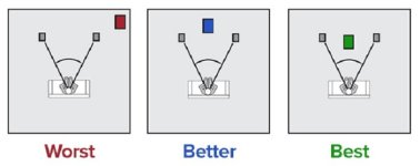

So bass is mono in the recording, it's directional because of room interfaces, and less directional as you free yourself of adjacent room surfaces.
I set up my room like the above diagram (unknown original source), and it works, it's the only thing that has ever worked for me.
Good video on getting the sub away from room boundaries.
https://www.acousticfields.com/ideal-subwoofer-placement-pressurization/
Lots of reading also lead me to believe the lesser of evils is using Low Line Level IC's inputs from a dual output preamp verses speaker wires to High Level Inputs.
Barry Ober says use a real crossover after the preamp and don't get upset about putting more stuff in your signal chain, if you only knew how much that signal has gone though in the recording process it would not be so precious to you.
Sorry, I got it to work to my satisfaction without another box and more wires.
I would not call my small room listening position "nearfield" however in regards to the subwoofer it is, and it works.

In audio we must try for ourselves.
But I always take into account when someone says that he has already done several experiencies (*) and concluded that ...
If we pay attention we can skip many steps. I wasted a lot of time trying the best position with the sub (**) because a lot of people say that the bass is omnidirectional and any place will do.
Even if when we listen to music we can´t say where the sub is, a bad placement can prevent you from reaching the full potential.
(*) To say that you read, or to transcribe someone's opinion, for me it is worth almost nothing.
(**) I have no issues with my room so I tend to assume as valid many of the conclusions that I reach.
