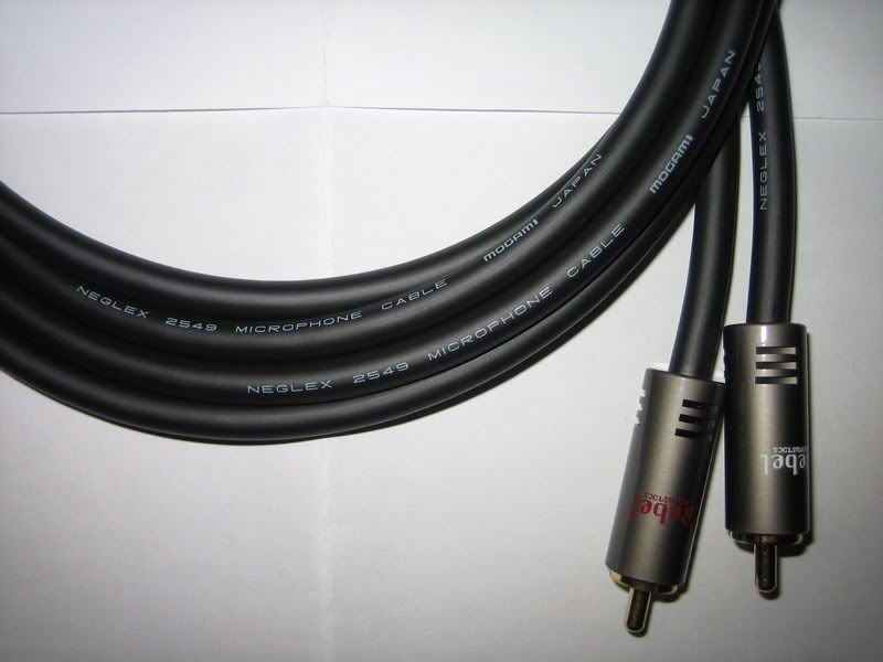

Steve . I want you to consider the "MOGAMI" cables. Get them and terminate with your choice of RCA adapters.
MOGAMI 2549 is made of Famous MOGAMI NEGLEX Technology Oxygen Free Copper. Terminated with improved version REBEL RCA Plug, thicker gold plated & professional outlook! Highly recommended for high end audio system!
Why MOGAMI ?
-MOGAMI Cable are MADE IN JAPAN
-Revered by Audio Professionals and Musicians for more than 50years
-Uniquely Clear, Accurate, and Transparent Sound
-Many Recording Studio use Mogami Cable, World Wide
-Superior Shield Technology Eliminates unwanted noise
-Superior NEGLEX Technology OFC and high quality insulator
-Highest quality Audio Reproduction in any application
