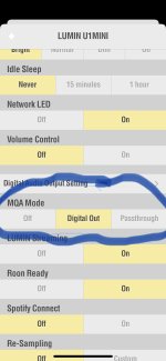

I have all of my digital outputs turned off as I’m using the AES to my dac. When going through the lumin faq web page they recommend using the analog output so the unit does the work before the dac for MQA. But on my iPhone for that setting I have no analog box to check. Dac is a bryston BDA3 any suggestions
Setting MQA to Digital output (default) is correct for your setup with a non-MQA DAC (or a MQA renderer).
