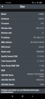

Please post a screen capture of Lumin app About function of U1 MINI showing USB VID PID and USB Device Number - these are the two fields I need.
Please disable Lumin Volume Control.
Hey Peter
heres a screencapture. Thanks! :)
Volumecontrol is disabled. Leedh Processing VOlume as well.
Your DAC is running an old Amanero firmware.
You need an Amanero firmware that is at least 2006be11 or newer. You should ask the DAC manufacturer for the exact version (which is 2006be11 or newer) that they tested and approved, and the detailed procedure to upgrade it.
