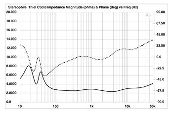

Tough ask. The 3.6 is a great speaker but it's a very tough load and required not only a lot of power but an amp with beefy power supplies that can deliver a lot of current (amperes). It's also a very revealing speaker so you want high quality watts/amperes. In the $2K range, you will likely come up short. Many will point to the NAD 375BEE as a good option but I don't think it will deliver enough on the current side. You may want to look for old school Class A Krell amps as a partnering amp (most of them will double power with each having of impedance and will be stable into a 2 ohm load). You will need an amp that is stable into a 2 ohm load because the 3.6 is under 3 ohms for much of the frequency band. From the Stereophile measurements section (http://www.stereophile.com/content/thiel-cs36-loudspeaker-measurements):
The CS3.6's impedance magnitude and phase plot (fig.1) reveals a very low impedance value. The loudspeaker is under 3 ohms through most of the range, dropping to a minimum of 2.3 ohms at 3.6kHz (the cursor position). The low impedance value explains the CS3.6's need for the iron-fisted Mark Levinson No.23.5 to provide control in the bass; the CS3.6 would appear to be current-hungry. There is, however, a consistency to the impedance curve that makes the CS3.6 look much like a resistor to the amplifier, rather than an impedance that varies greatly with frequency. The phase angle—represented by the dashed line—is quite benign. The passive radiator tuning can be seen as the valley centered at 29Hz.
