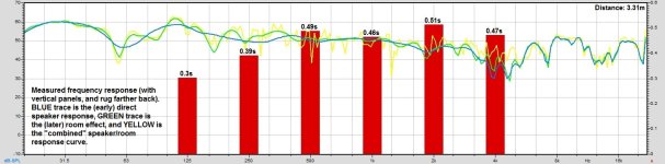

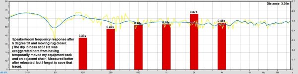

Here's some before/after XTZ measurements. The ~60 Hz "dip" in the AFTER pic is actually a little better now, but I just ordered the XTZ v.2 Pro kit (better mic) and will repeat the measurements with the higher res mic before further tweaking.
BEFORE
AFTER
