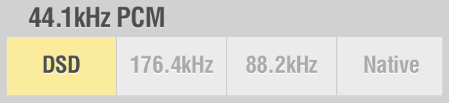

Hi Mike
The manual page is here: LUMIN Resampling Settings
Basically when you select 'Custom' all the settings open up below for each sample rate.
For upsampling FLAC 16/44 to DSD you would select this one (depending on your model there may be other options in the list):
(you may as well do 48kHz PCM too as you're in there).
You can leave all others at 'Native' if you like and see how you like it.
