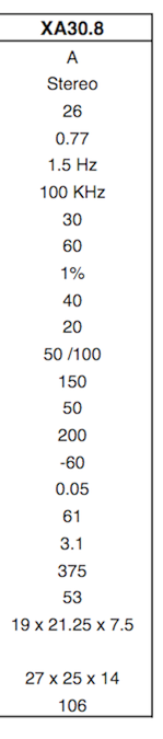

The 30.8 has more power than the INT-60, and each makes twice as much power into 4 ohms as 8.
Now I remember I read somewhere about that. But how much more power 30.8 has, I cannot find any info about it.

Thanks Joe. Not sure where people heard the 30.8 is more powerful than the INT-60. The INT-60 is a 110 pound monster and will drive all but the most inefficient speakers. It's a great sounding piece.
According to Pass (and I'm pretty sure I also read it in a review of the 30.8), the 30.5 tops out at about 120 W/ch @8 ohms, A/B; the 30.8 about 90 W, and the INT60 just under 80. True, that's only just over a 1 dB difference between the three.
