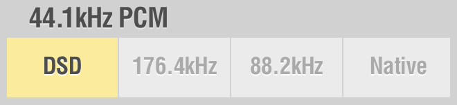

How do I set custom settings on Lumin T2. Streaming Qobuz sounds great with custom set to off but want to improve sound of my CD's that I stream through a Network Hard Drive with Lumin. Is there a specific setting for CD's? Thanks
If you're using digital output, please keep Re-sampling disabled.
You may disable any unused services such as Roon Ready, Spotify Connect, Tidal Connect, AirPlay "Lumin Streaming".
I am connected with analog cables. There are no specific settings under custom for CD's?
If you wish to try upsampling ripped CDs then just leave everything else at 'Native' and change 44.1kHz to either 176.4kHz or DSD.
Try both and see which you prefer.

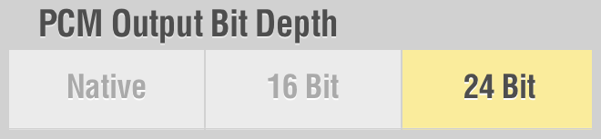

You can also change PCM Output Bit Depth to 24-bit. Again - see which you prefer.
If you like what you hear when upsampled, then you may as well change the 48Khz settings to match.
