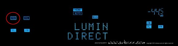

What is the purpose of the HDMI output on the Lumin S1? Would HDMI output bypass the D/A converters?
As joeinid pointed out in another thread, Lumin can output 2-channel PCM or DSD signal via HDMI. Yes, it bypasses the D/A converters. The other (probably better) digital output is to use the BNC SPDIF output, which support PCM and DSD-over-PCM (DoP) over coaxial, if your DAC support that.
When the Lumin A1 was first introduced, HDMI was the only option to output DSD signal in early firmwares, before Lumin adds support for DoP over coaxial later.
