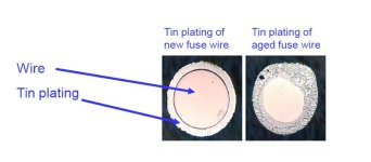

4) Pulse factor derating of the fuse wire. As a fuse wire is subjected to pulses of high current. Every time you turn your system on the fuse wire ages. See the attached picture of the cross-section a new fuse wire versus an aged fuse wire. The pulse factor derating tells you how many times you can turn on/off your amplifier before you should to replace the fuse.
An aged fuse wire will break more easily, but we might also infer that it won't sound as good. When replacing a 3-year old fuse that is close to the end of its life-span with a brand new fuse, you might conclude that an audiophile fuse made your system sound better when it actually could be because you replaced an old, worn-out fuse with a brand-new one.
