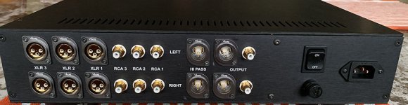

With the recent discussions about the Hattor preamps, I thought I'd post some photos of a handbuilt preamp I recently completely which uses a relay-based input selector and shunt attenuator from Khozmo. I'm using a fully balanced attenuator (four channels of attenuation for stereo), which then feeds a buffer board with both balanced and single-ended outputs.
The Khozmo is built using Takman REY shunt resistors and Vishay Z-foils for the series resistors. All the rest of the signal path resistors are also Vishay Z-foils. All wiring is solid-core silver with teflon insulation.
I have two balanced outputs - one directly from the buffer, and the other with series MiFlex KPCU copper-foil caps. This second output rolls off the bottom couple octaves. Depending on the input impedance of the amp, the -3db point is between 40Hz and 80Hz. My speaker system uses an active servo-controlled open baffle subwoofer for each channel which can handle up to about 200Hz, so having the passive roll-off for the upper frequencies puts a bit less stress on the speakers and amp.
I am thrilled with the sound - by far my most successful DIY electronics project so far. My Parasound JC2-BP that you see sitting below my new preamp in the photos is now for sale.

Neat layout and wiring. Looks great. I bet it sounds awesome. Is that a Modushop chassis ?
Thanks guys. No relation to the company that makes the CD transports. Just my first name. :D
Yes, this is the Modushop Slimline 2U purchased through the DIY Audio store. They've been great to work with as well. I also used their cases for a pair of small monoblocks, and have another pair on the way now for a pair of Purifi-based class D monoblocks that I'm building with a 1500VA linear power supply for each channel. I hope to have them done by Christmas (at least version 1 - I'm planning to experiment a bit with different buffer designs).

Thanks. I debated with myself on how to do the grounding and did a bunch of online research to get ideas. What I ended up with seems to work really well. No audible hum or hissing coming from the speakers. The heavy copper plates are probably overkill, but hey, that's what diy is all about. I'm there only one I have to please :D
