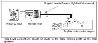

And I do have this really smart question, as I have not used subs before: how and where do I connect the sub? How is it done if I have a) one or b) two of the REL S5s?
With the REL the prefered method is speaker level and they provide the cables to get started in the box.
REL is connected like this, but note that this is different from most other subwoofers:
Excellent, this will work wonderfully with my Ayre VX-5/20.
