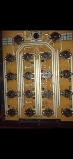

This is what the amps look like with the sides and top removed. There are parts on the bottom of both boards but I don't have pics of them at this time.

With the Power regulator tube going down the first thing he needed to do was find out why and did it do damage to anything else. He checked parts in the path the power followed and everything except the resistor directly at the tube was fine. It appeared the resistor went bad and allowed the tube to runaway at full power. He temporarily replaced that resistor and checked the value of EVERY resistor, diode and capacitor in the amp.
Phil had been able to acquire a complete set of schematics and parts list. originally used by ARC along with the upgrade schematics and parts list.
After determining that the other parts in the amp were fine to operate he put it in standby for 25 minutes then in operate position for 15. Everything was operating properly so he moved to the second amp and tested all parts as in the first.
This pic is really only exciting to Phil and myself when the repaired amp glowed happily.

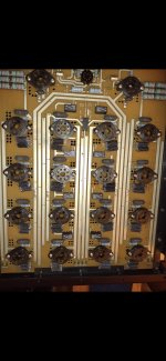

Once it was determined that the amp was functioning properly it was time to move ahead. After a few conversations about the amps I said that any parts he thought should be replaced and he was willing to undertake I was in favor of. I had know idea how much work I had created for Phil when I said that. There had to be moments he thought, what have I gotten myself into.
The first thing to strip all of the parts to be replaced on the top board relating to the power tubes and driver tube resistors. The top pic.
Middle pic shows parts removed and all holes cleaned to receive new resistors and relays.
Bottom pic shows all the new parts installed on the top board. All of the resistors he uses are noninductive type.

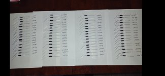

For the proper resistor pairing Phil first checks the value of each one of the 220 resistors being replaced. For some to achieve the proper .2 ohm value
2-.1 ohm resistors are soldered together and value checked again. He is able to match the values for each tube pairing for purposes of biasing the banks of tubes.
Virtually all of the pairings are exactly the same with the farthest difference being .001 ohm.
First pic shows testing of 64 of 220 single resistors and their value.
Second shows pairing and again the value so pairing can be completed as perfect as possible.
