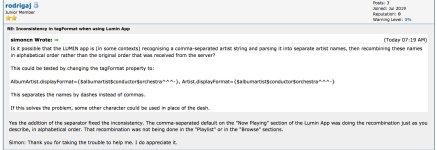

    I recently purchased a Lumin A1 and have set up Minimserver tagFormat to my preferred format of "AlbumArtist, Conductor, Orchestra".
    I get consistency on two locations where this tagFormat is used in the Lumin App and on my Lumin A1 screen. However, the top "AlbumArtist, Conductor, Orchestra" string does not follow the tagFormat rule.
    @wklie please advise. Am I doing something wrong?

    @wklie: My specific question is how does Lumin App treat MinimServer
    tagFormat
    AlbumArtist.displayFormat={$albumartist$conductor$ orchestra}
    It appears to use the string as expected with the exception of the top line (see my pict in the original post).
    I should also mention that I use
    tagOption
    AlbumArtist.reverseName.display, Composer.reverseName.display, Conductor.reverseName.display
    if that matters at all. I use these tagOptions because I prefer indexing with LastName, FirstName and display with FirstName, LastName.
    All works well, and displays as it should except for the top section of Lumin App.
    If this is a question better answered by Simon at Minimserver, please let me know. I did not think it would be so I came here first.

    In the interest of closure, Simon Nash over at Minimserver solved the inconsistency. A screenshot of his reply and my followup response:
